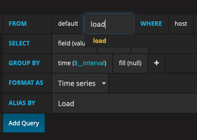

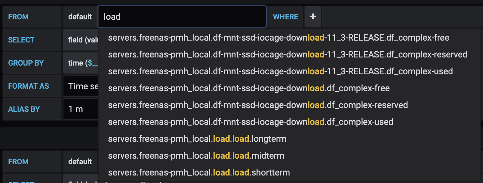

Hello...
I've successfully installed a graphite server using influxDB and Grafana, and I've started pushing data from an 11.2-U5 server. I am able to create a few graphs, and I am happy about it.
However, I noticed that not all the information that is presented in the built-in graphs are available. For example:
- There is only one "system load" metric. I can't find the 3 1-min, 5-min, 15-min system load metrics
- Disk I/O (metric "disk_octets") looks like it reports only write data, not read data.
- Network I/O ("if_octets") looks like it reports only incoming data, not outgoing.
These are the problems that I've found just looking at it for half a day. I looked at the various fields in the influxDB database and I couldn't find anything that may have the more complete metrics. Am I missing something? Is there a way to get all the metrics that I can get from the original built-in Freenas "Reporting" page?
Thank you!
George
