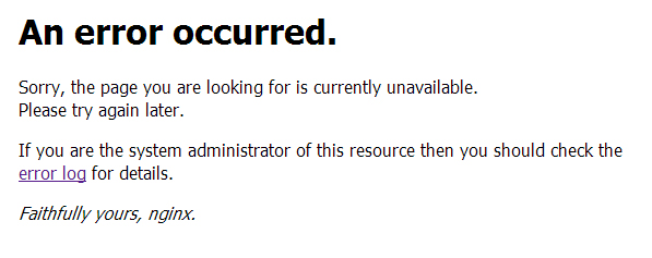

Alright, thanks. As long as it's not anything too serious, I guess I can live with it until a fix. I might as well add that I've been getting this error message a LOT lately (image attached), especially since updating to 9.2.1 (and now into 9.2.1.1).
