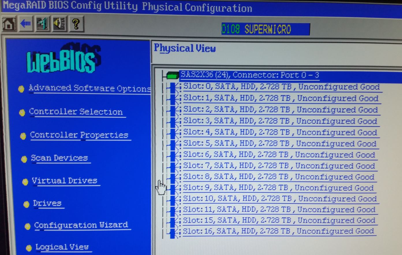

Dear experts, I have installed freeNAS on Supermicro 6047R-E1R24N with 16 hard drives and LSI MegaRaid SuperMicro SMC2108 controller. 16 Hard Drives are not configured to any virtual drives, as of now independent.
Looks like freeNAS is not detecting them. Can I use LSI SMC2108 controller at all with freeNAS? Seems like I have to research how to make them start working with freeNAS.
Thank You

lspci shows
05:00.0 RAID bus controller: LSI Logic / Symbios Logic MegaRAID SAS 2108 [Liberator] (rev 05)

You probably need to flash your card into IT mode. Raid cards do not work with zfs.

You might be SOL with that card. I don't believe it supports passthrough mode nor flashing to IT firmware. Because of that, it would not be a good choice for use with FreeNAS. You may need to get an LSI/Avagotech HBA card.

If I use that card do I have to do anything from freeNAS like install manually drivers, ect.? Or it will be detected by freeNAS?

You will never install drivers on freenas. It should all just work out of the box if you choose the correct hardware.

Looks like I was able to set raid0 for each drive and now freeNAS recognize all of them

Bad idea. If this is or is going to be a production system, it is highly advised to NOT do this. You really need to have a card that offers true passthrough/HBA mode or you increase the risk and likelihood of zpool corruption.

Have you not listened or read anything we have been saying? You should not I use this card.
