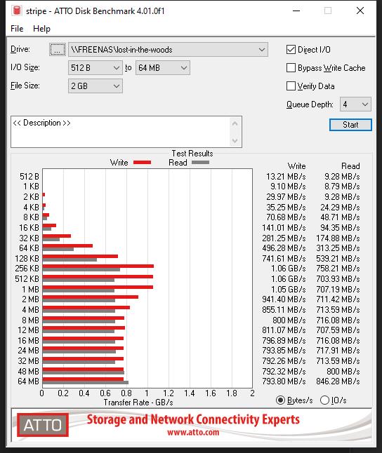

have been doing more testing but I can't get the read speed past 750'ish MB/s
it's not the network, I've seen numbers up to 1.08Gb/s
For some reason, 10 disks in stripe mode, don't want to surpass the 750MB/s mark... I don't know why?
The HBA is LSI 9205-8i, surely that is not a bottleneck? I'm not sure if it's the drives themselves or the server (cpu/ram) but I'm going to try an SSD stripe to see if I can get past the cap.

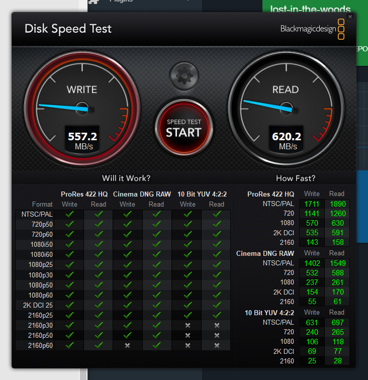

this is the ssd stripe,
speeds are about the same (ever so slight increase) but you can clearly see a trend, right? Every benchmark tool caps at the same levels! Is it a coincidence? I wonder what is going on.
Next step is to disable HT. Then start disabling cores.
