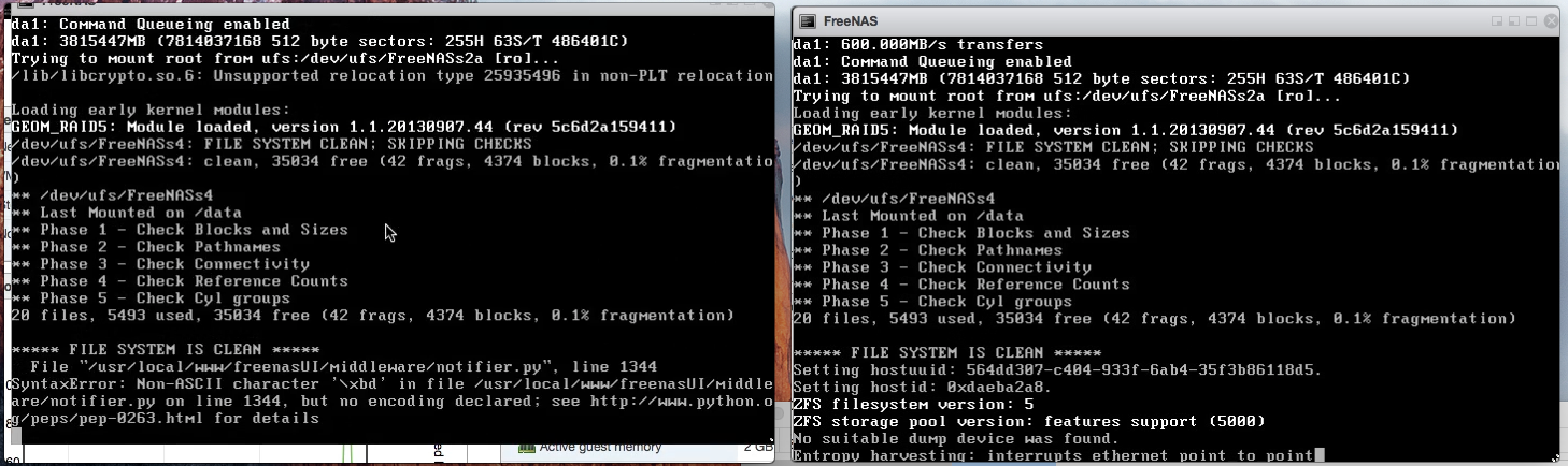

My FreeNAS 9.2.1.9 VM will not start after my USB stick is smoked with ESXI 5.5 and I have taken the opportunity to update to ESXI 6.0 .
Passthrough of LSI 2308 is reactivated but something will not longer work after Freenas I received it in the inventory and would like to boot . It seems to have something to do with the bypassed LSI .
In safe mode, it starts but how do I get it back again it starts in normal mode .
Do you think there's something to save or should I create a new VM FreeNas and import the ZFS pool again?
I once made a screen capture from the boot and made a screenshot .
Left side in normal mode where it gives up and right in Safe Mode .
