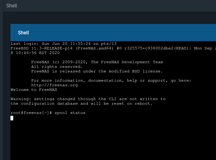

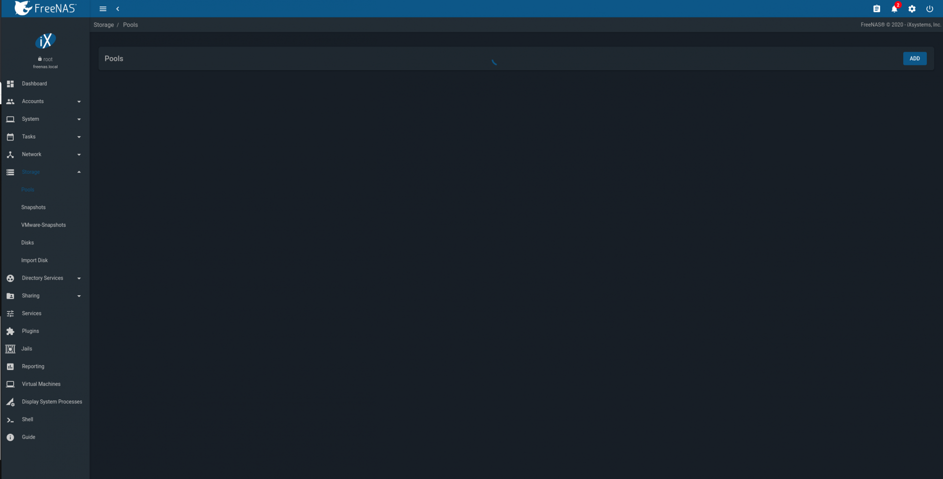

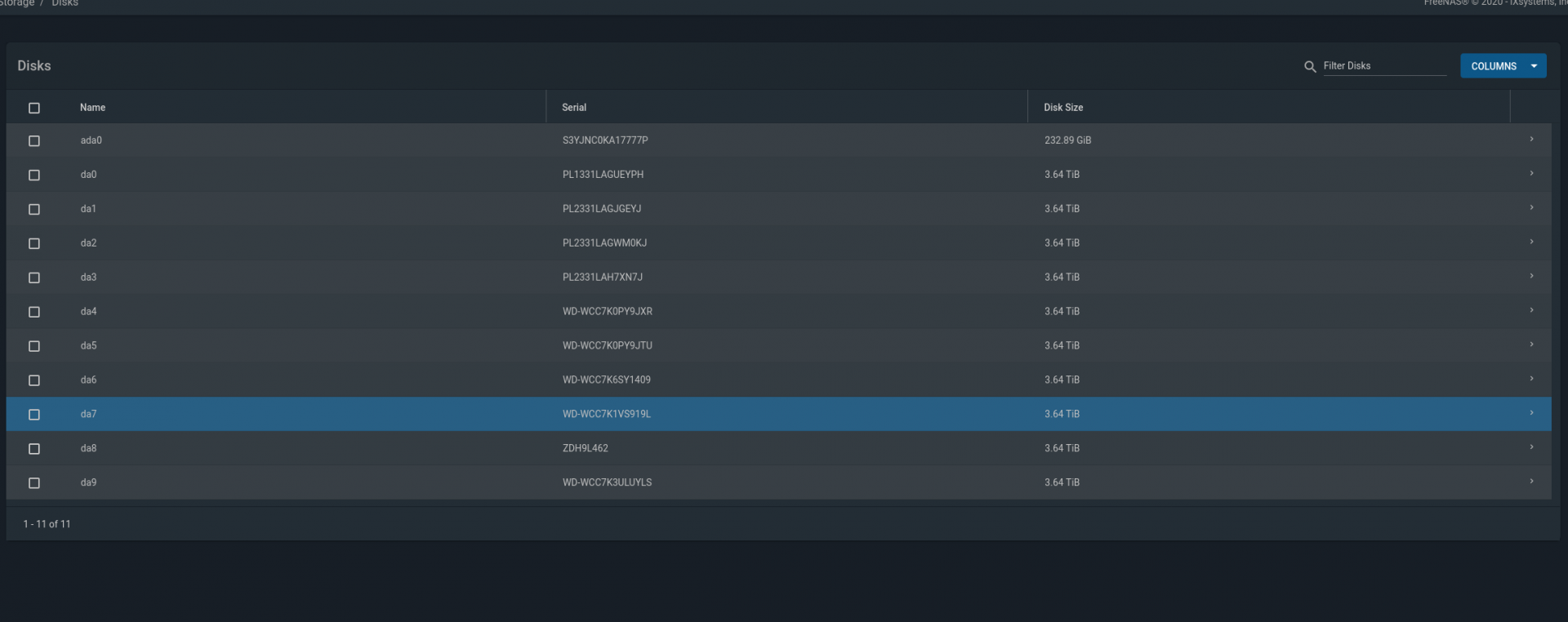

Now i got a dedicated storage system, having the same RAID Controller, but now i wanted to perform a resilver process. Unfortunately the system becomes unresponsive , and the "dashboard" does not display anymore. Also "zpool status" and all these zpool commands simply hang and give no response.
What might be the issue here? Unfortunately one disk failed so i have to complete the resilvering process because one disk failed. But i am not able to finish the resilvering process because the system becomes unresponsive.

Not responding:
Page not loading
