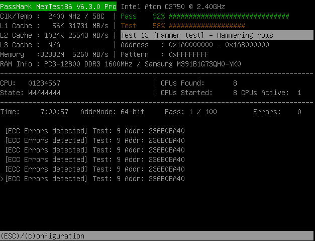

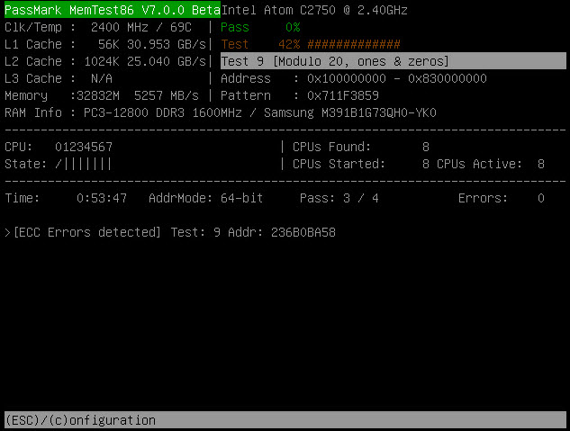

I had three passes go through without errors. There were some mentions of some ecc corrections happening though. I had stopped the test to try out the 7.0 beta of memtest since it had a number of improvements for the ECC tests, but IPMI locked up on me when I attempted to remotely mount the iso and I couldn't regain access until now. I'm running the 7.0 beta now. Note this is a free download and is the "pro" version if anyone wants to play: http://www.passmark.com/forum/showthread.php?6064-MemTest86-v7-0-Beta-1
SnakeByte
Jul 10, 2015
53

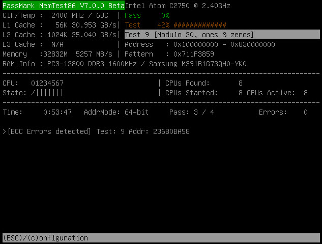

So with 6.3.0 Pro, it had discovered some "ECC corrections" while running in Test 9. However, the 7.0 beta specifically has changes for the ecc tests with the Atom C2000 chipset series (what I'm using - C2750) as well as some other updates to ECC testing in general.
Since booting into 7.0, and only running test 9, 3 passes came up completely clean, but a fourth discovered that ECC correction thing again. While the ecc correction means that the corruption was fixable, it's still something that I will try to get replaced.

Thanks for the hint Ericloewe. I keep underestimating what IPMI can do. What's interesting however is this:
Memtest did not detect any uncorrectable ECC's. Hmm. But I did reboot the system to pull another debug log dump, so it's possible that happened while FreeNAS was running.
Now here's the weird part. So far, to date, the only time memtest has detecting something it as been with Test 9. And then only at one specific location, and finally only "errors detected" -- never a failed event:
So I adjusted the settings to only do test 9, and then only within this range: 0x236b0b000 - 0x236b0c000

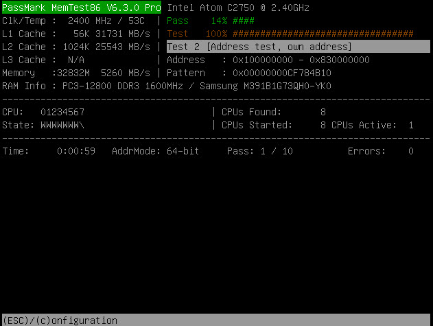

I went through 99 passes -- nothing found. :(
So I reset the ranges back to defaults and started testing again -- maybe the range was too small to apply the patterns correctly? Oddly, after 10 passes, nothing was found.
I've reset ALL tests back to default and am running it over night. I really hope I can get this to find something again because I just asked iXsystems to send me out a dimm and won't be able to tell which dimm to replace if I can't repeat the problem.

If a system kernel panics, that can result in false uncorrectable ECC errors. The reason is that the memory controller is left in an inconsistent state. I had no idea that this was possible and wrongly tried to RMA a system's RAM because of the issue.
Considering all of the information I have, your RAM appears to be just fine and replacing a DIMM isn't going to fix a thing. It could make things worse for you though because you're changing parameters that, for now, are static.
What is test 9??
Row Hammer was turned down a bit because errors were surprisingly common.
Cyberjock,
The uncorrectable ECC errors that IPMI detected happened days after that random reboot event. There hasn't been another kernel panic since then (mainly because I haven't been running FreeNAS -- just the mem test). I only very quickly ran FreeNAS to pull another debug file for you and it didn't crash or otherwise show issues.

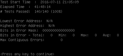

I just checked in on the system today. All tests ran 140 times across the entire memory range of addresses without a single error. This was while running the beta though. I'm going to go back to 6.3.0 pro and see if the errors re-appear.

According to their documentation (http://www.memtest86.com/technical.htm):
Test 9 [Modulo 20, Random pattern]
Using the Modulo-X algorithm should uncover errors that are not detected by moving inversions due to cache and buffering interference with the algorithm.
The Row Hammer test is Test 13. That always came up clean for me in both 6.3.0 and 7.0. I believe they even made it more aggressive in the 7.0 beta (http://www.passmark.com/forum/showthread.php?6064-MemTest86-v7-0-Beta-1):
  • Row Hammer Test (Test 13) now uses double-sided hammering and random data patterns in an attempt to expose more RAM modules susceptible to disturbance errors. During our testing we observed double sided hammering was effective at high frequencies, but at lower frequencies single sided hammering was more effective. So feedback on this would be good.

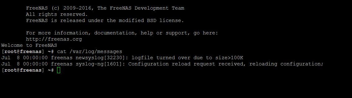

This was in the end of the /var/log/messages file:
Jul 19 16:00:04 freenas autosnap.py: [tools.autosnap:61] Popen()ing: /sbin/zfs snapshot -r "trunk@auto-20160719.1600-1w"
Jul 19 16:03:39 freenas ipmi0: KCS: Failed to read address
Jul 19 16:03:39 freenas ipmi0: KCS error: 5f
Jul 19 16:03:46 freenas ipmi0: KCS: Failed to read address
Jul 19 16:03:46 freenas ipmi0: KCS error: 5f
Jul 19 16:03:51 freenas ipmi0: KCS: Failed to read address
Jul 19 16:03:51 freenas ipmi0: KCS error: 5f
Jul 19 16:03:51 freenas ipmi0: Failed to reset watchdog
Jul 19 16:03:57 freenas ipmi0: KCS: Failed to read address
Jul 19 16:03:57 freenas ipmi0: KCS error: 5f
Jul 19 16:04:04 freenas ipmi0: KCS: Failed to read address
Jul 19 16:04:04 freenas ipmi0: KCS error: 5f
Jul 19 16:04:09 freenas ipmi0: KCS: Failed to read address
Jul 19 16:04:09 freenas ipmi0: KCS error: 5f
Jul 19 16:04:09 freenas ipmi0: Failed to set watchdog
Jul 19 16:04:17 freenas ipmi0: KCS: Failed to read address
Jul 19 16:04:17 freenas ipmi0: KCS error: 5f
Jul 19 16:04:23 freenas ipmi0: KCS: Failed to read address
Jul 19 16:04:23 freenas ipmi0: KCS error: 5f
Jul 19 16:04:29 freenas ipmi0: KCS: Failed to read address
Jul 19 16:04:29 freenas ipmi0: KCS error: 5f
Jul 19 16:04:29 freenas ipmi0: Failed to set watchdog
Jul 19 16:04:35 freenas ipmi0: KCS: Failed to read address
Jul 19 16:04:35 freenas ipmi0: KCS error: 5f
Jul 19 16:04:41 freenas ipmi0: KCS: Failed to read address
Jul 19 16:04:41 freenas ipmi0: KCS error: 5f
Jul 19 16:04:47 freenas ipmi0: KCS: Failed to read address
Jul 19 16:04:47 freenas ipmi0: KCS error: 5f
Jul 19 16:04:47 freenas ipmi0: Failed to set watchdog
Jul 19 16:04:54 freenas ipmi0: KCS: Failed to read address
Jul 19 16:04:54 freenas ipmi0: KCS error: 5f
Jul 19 16:05:00 freenas ipmi0: KCS: Failed to read address
Jul 19 16:05:00 freenas ipmi0: KCS error: 5f
Jul 19 16:05:06 freenas ipmi0: KCS: Failed to read address
Jul 19 16:05:06 freenas ipmi0: KCS error: 5f
Jul 19 16:05:06 freenas ipmi0: Failed to set watchdog
Jul 19 16:05:12 freenas ipmi0: KCS: Failed to read address
Jul 19 16:05:12 freenas ipmi0: KCS error: 5f
Jul 19 16:05:18 freenas ipmi0: KCS: Failed to read address
Jul 19 16:05:18 freenas ipmi0: KCS error: 5f
Jul 19 16:05:24 freenas ipmi0: KCS: Failed to read address
Jul 19 16:05:24 freenas ipmi0: KCS error: 5f
Jul 19 16:05:24 freenas ipmi0: Failed to set watchdog
Jul 19 16:05:31 freenas ipmi0: KCS: Failed to read address
Jul 19 16:05:31 freenas ipmi0: KCS error: 5f
Jul 19 16:05:37 freenas ipmi0: KCS: Failed to read address
Jul 19 16:05:37 freenas ipmi0: KCS error: 5f
Jul 19 16:05:43 freenas ipmi0: KCS: Failed to read address
Jul 19 16:05:43 freenas ipmi0: KCS error: 5f
Jul 19 16:05:43 freenas ipmi0: Failed to set watchdog
Jul 21 00:00:00 freenas newsyslog[95493]: logfile turned over due to size>100K
The IPMI stuff happens on occasion -- apparently it's a harmless quirk of the mini:
https://bugs.pcbsd.org/issues/5429
