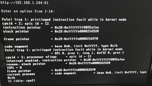

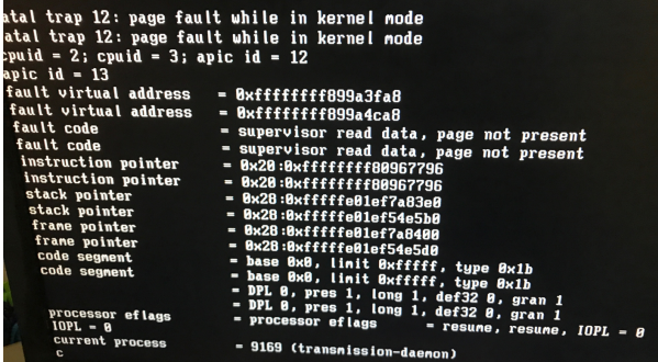

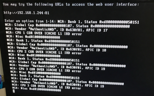

I have been using freenas for about 18 mths and only after updating to 9.10 ver and then downgrading to 9.3 that I have seen multiple error to my freenas system. I have to been able to narrow down the issue, whether it is hardware or software issue ? I am also not using non ECC ram, AMD CPU &FM2A78M-ITX+ MOBO Appreciate anyone help on this. Thank you
I have manage to take some error shots when system keeps rebooting after fulling booting up.

To verify the integrity of the FreeNAS installation do a Scrub Boot and a Verify Install.
System -> Boot -> Scrub Boot
System -> Update -> Verify Install
If nothing suspicious pops during these tests up I would run an exhaustive test of memtest86 on all the system memory.

Sounds like your hardware is not doing well. You have at least two very different panics just in this set of images.
Burn it in again to debug this issue.
