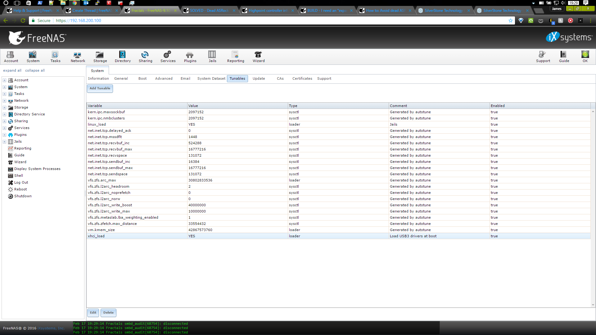

I have two SilverStone TS431U USB3/eSATA cases, each holding 4 drives, and when connected via USB3 to my FreeNAS box [via a VantecPCIe UGT-PCE430-4C USB3 PCIe card], only 1 drive per case is recognized and listed in /dev and Storage -> View Disks. I've tried all 4 USB3 ports on the PCIe card with the same results on each one.

I do have the xhci_load tunable active (a holdover from 9.3), and there are several tunables that were set by the system, via autotune, at some point after upgrading to 9.10, or by one of the 9.10 updates [see attached screenshot].
  • I've tried with xhci_load enabled and disabled, with no difference either way in regards to this specific issue.

In case anyone else runs into issues getting a USB3 PCIe card to recognize a multi HDD external casing, perform the following:
  • If utilizing FreeNAS 9.10 backwards, tunable xhci_load YES loader must be set
  1. Edit /etc/devfs.rules
    • Add: add path 'da*' mode 660 group uucp
  2. Issue command: usbconfig
    • Locate the ugen number for the external casing, such as ugen0.2
  3. Issue command: usbconfig -u 0 -a 2 reset
    • The HDDs should now be visible under /dev, as well as in BIOS/UEFI upon reboot
  4. Issue command to verify: camcontrol devlist
