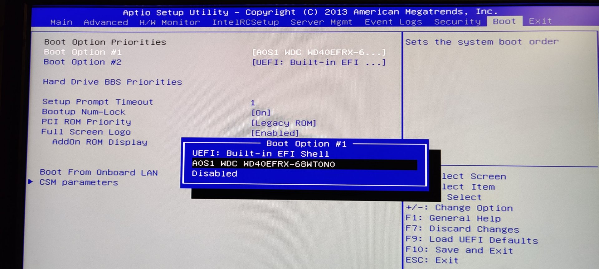

I actually installed it with BIOS first time and then the second with UEFI. For reference, this is the motherboard
Both options yielded the same results but I have added some screenshots to help explain the scenario better.

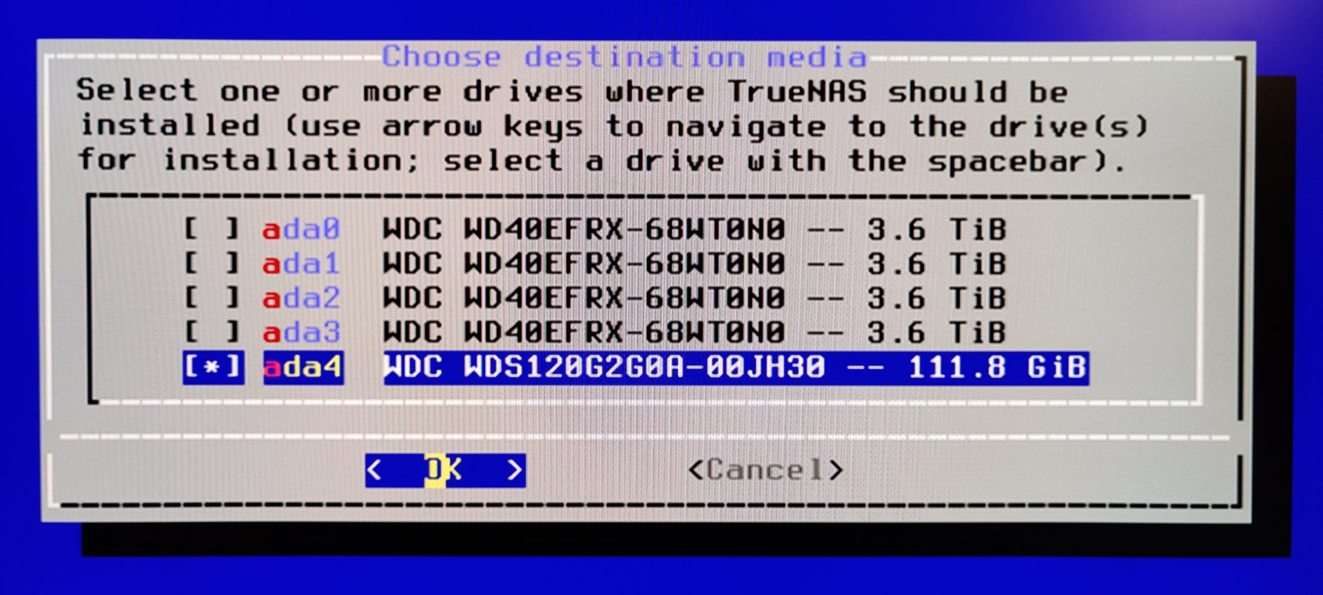

Here you can see ada4 points to (00JH30) the boot drive I am installing to. I did this as UEFI with the "Format the boot device" option. After reboot take out flash drive and look at my BIOS settings.

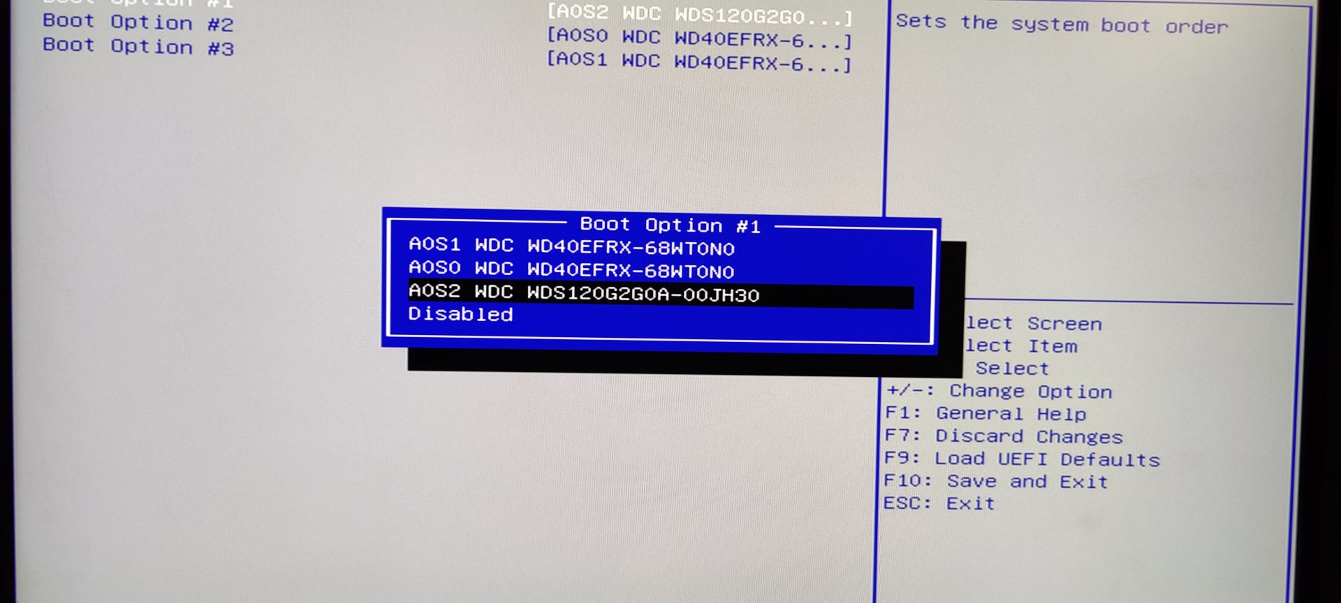

I don't understand why I can only see the other drive (68WT0N0 not the one I want). I also found the additional setting "Hard Drive BBS Priorities" which showed the following drive
I selected this to move up the priority list, save changes, and still same issue... I also don't think this is a faulty SSD drive either given everything I went through.

This is semi-obscure problem but after many different combinations, I finally got it working.
  • force proper drive order via BBS priorities as mentioned above
  • boot up bootable media as *SANDISK UEFI* (not just the regular SANDISK USB boot device option as there was a difference)
  • and installed it as boot via BIOS (I believe I selected this)
  • Reboot, left install USB in (despite instructions saying its ok to remove) but force/verify boot order was the main install SSD.
