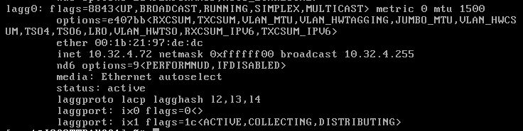

followed issue1, I tested the failover for the two links, disable one port in the port channel, the network was broken, the other link was not brought up. see attached screenshot, one interface in the lagg is not showing status.
workaround: have to change the lagg configuration from lacp to failover and everything is functioning as expected.
