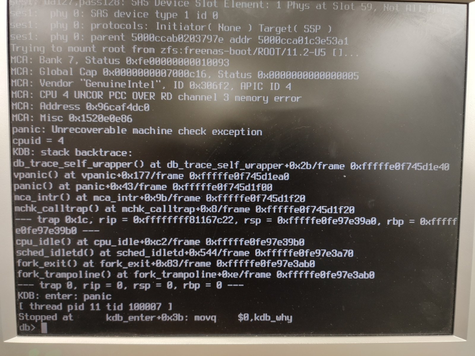

When the NVdimm is populated, the freenas is starting and crash with this following error:
If someone have any idea of what to do !

The shown "Unrecoverable machine check exception" probably means that the NVDIMM was used in some other system and does not consist valid ECC data for this system (it may depend even on specific memory topology within the system). So any attempt to access it end up in exception and following panic, since it is practically a fatal memory error. What you need to do is forcefully wipe NVDIMM to make it restart from scratch. How to do it depends on motherboard. Some may have BIOS options just for that. Sometimes you may be able to disable saving on S5 and then shut down your system clean from the OS. As the most barbaric way it may help to disconnect battery backup unit from the NVDIMM module on the running system and then pull the power from the system, so that NVDIMM could not back up its content to flash and restart clean later.
