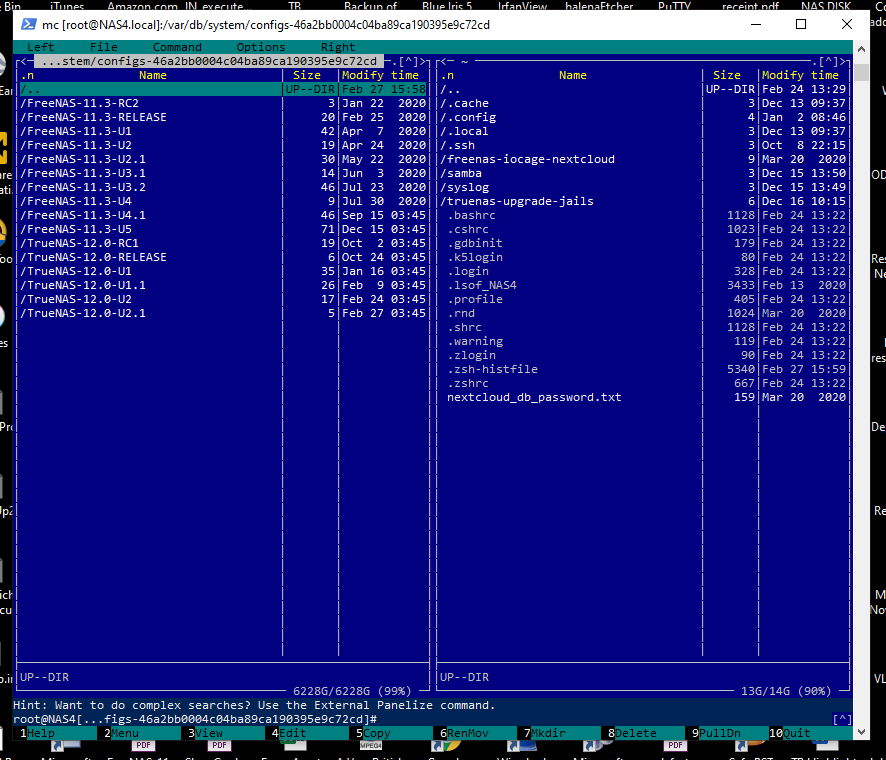

Start as JohnDigital suggests - get the latest version of TrueNAS on a new boot drive and boot up your machine, log in to the GUI. But, before attempting to import your pool, go into shell and cd to /var/db/system, and list the contents with ls. If you find a listing like "configs -- a big hex number" , open the latest dated version and your latest config file and the the id of the last version FreeNAS you were using will be in there. Here's what MC (Midnight Commander) is showing on one of my boxes for my latest saved config file set:
Then you have a choice - use that config file with the latest version of TrueNAS and work out any issues as JohnDigital suggests, or alternatively download the actual version of FreeNAS that you were using at the time of the crash, put that on a new boot medium, boot up that version, load the found config file and import your pool - at that point you should be back at square one.

There may be a way to get you back right were you were with your original config.
@Redcoat
Too late, I already imported my pool. I'm guessing I just have to stick with what I have now.
I do have stuff in the location you specified, but I'm guessing that's now the new configurations from TrueNAS.
For Sh--s and Giggles, take a look - my guess is one Config- is your new one, one has the old info. Try out MC.
