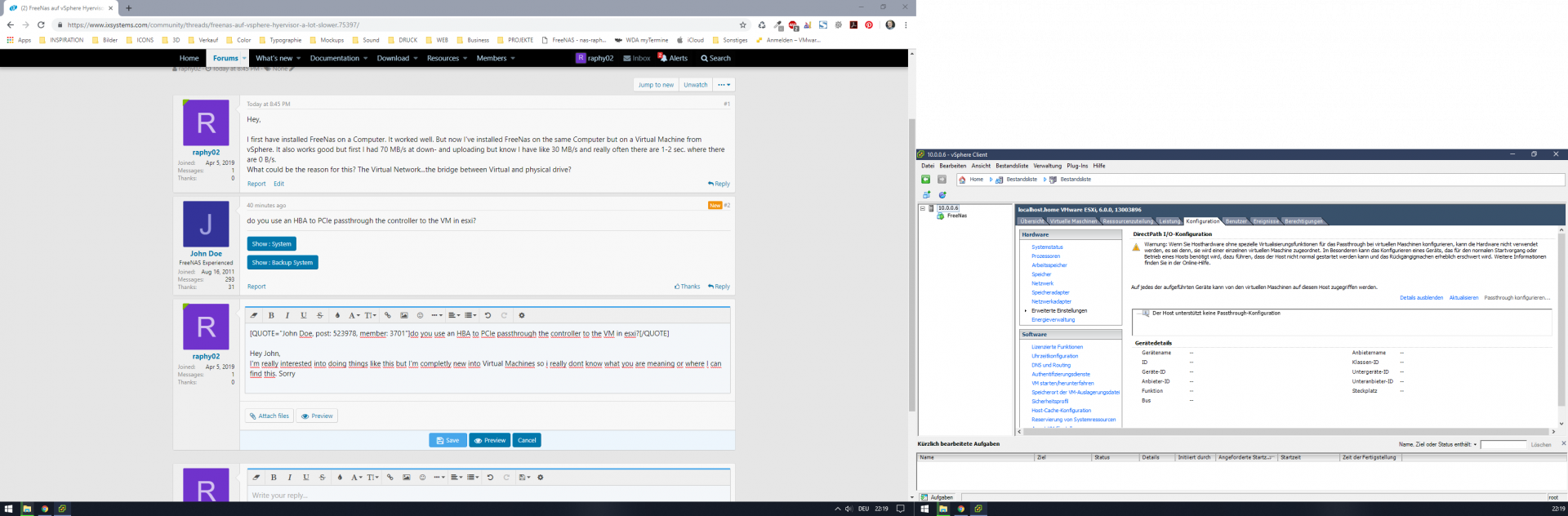

Hey John,
I'm really interested into doing things like this but I'm completly new into Virtual Machines so i really dont know what you are meaning or where I can find this. Sorry.
Could it be this?) Sry I'm german.
