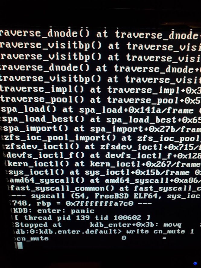

Hello, been a very long user of Freenas since around 2007ish, back when it was still very simple to use. Over the years I have upgraded with new releases, but never really understood all the new corp level features and such, but my Freenas chugged along.
Anyways, needless to say, I am a long time user newb. My current and trusty Freenas no longer works. The first problem was that when I went to start it up, I got a "This is a NAS data disk and cannot boot system". Ok, fair enough, my flash drive has died. So I buy a 120GB SSD, install on that, and go to reimport my backup file, only to get a looping reboot after the "syncing disks" part, and I also catch it saying "panic" which cannot be good. I also tried to reimport the ZFS pool,instead of uploading my backup config, and also got the same error.
As a last resort, I was able to get my failed USB drive to finally load up again somehow, and it now has the very same looping issue as noted above. There is one thing that changed during all of this as well. When I installed the SSD, I unhooked the first of my 3 disks (cannot remember what RAID level, but 3 1tb disks) from the sata 0 port so I could plug the SSD in there and move all the disks down one sata port. During this, the sata port plastic pulled off the MOBO, so now I have my SSD plugged into SATA1, with the remaining 3 disks following it. I do not know if that has anything to deal with my issue.
Also, I do not know how to dump a log, to even look at what is failing.

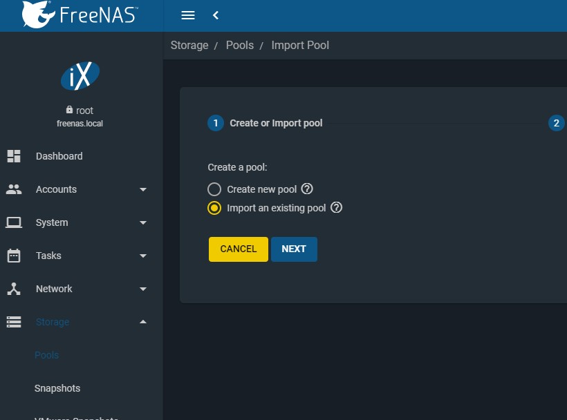

So I tried to disable the ports that have been damaged (now 2, same plastic), but am unsure if they actually are disabled in the bios, I was able to cut power to them and that was it.
Fresh installed Freenas to the new SSD, tried to import the pool, it saw the pool and said it was importing, but then it restarted, and has the same error as before.

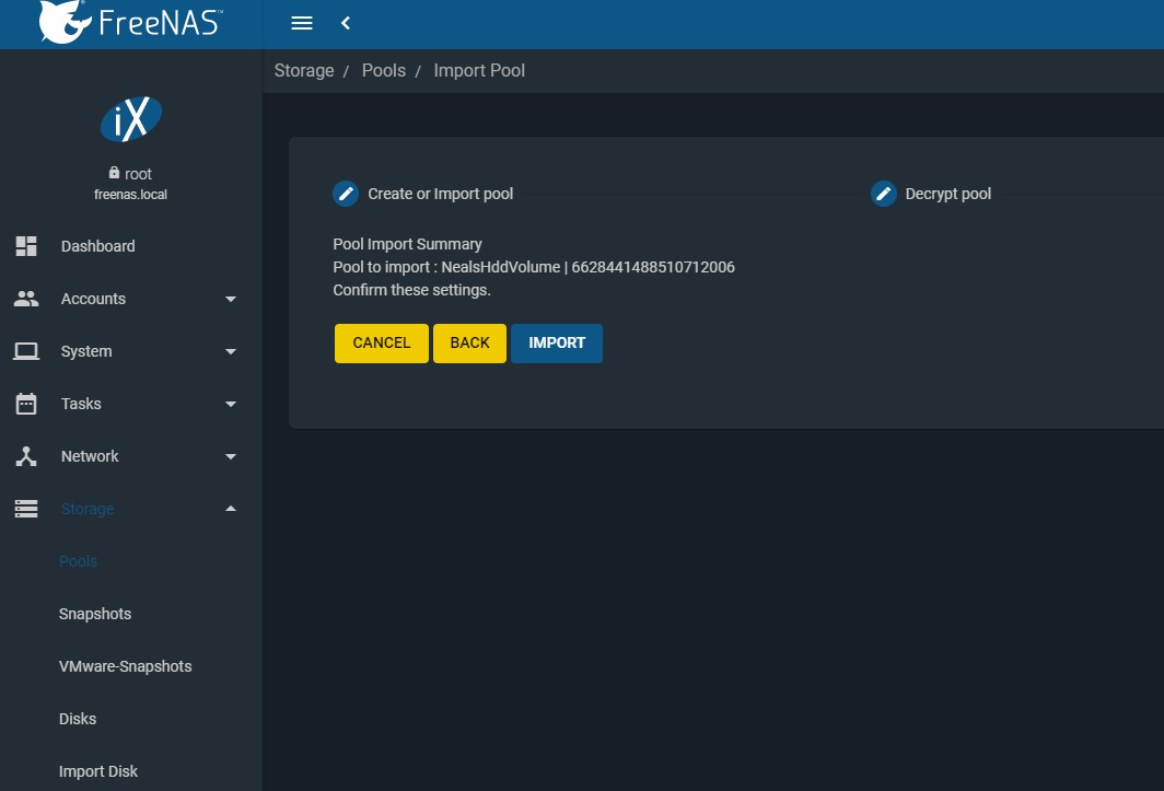

Ok,
So I have now purchased a new MOBO, CPU and RAM (couldn't use old ddr3) and have assembled it. I still have the same exact problem after importing my pool manually and not using the config. Any ideas now? I am hoping that the initial boot disk failure did not coincidentally also have a drive failure in my pool.. It does see my pool just as it did on the old hardware, it just fails after adding it.
ihateu3
May 12, 2016
11
Was able to recover somehow (it didn't seem to work until at first) from this thread
So I was able to import my pool, that is good news, but now for some reason I am having issues connecting through windows, even after importing my old config, so I am not sure if it somehow messed up my share. I hate permissions stuff.

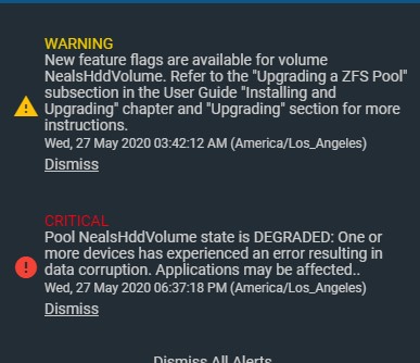

I was able to delete my old Samba share, make a new one and point it to my old dataset on the pool, and was able to get back in to everything that way.
Now that I am up and running, is there anything I should do to make sure everything is safe and secure now? I thought I was safe before, but just to make sure I am doing everything right since the whole reason of running this is for data security for me.

Not everything is OK... watch out on that disk... CRC errors at that level can indicate some issues with the disk controller board talking to the SATA controller.
I got this error today, but it does not tell me which disk it is. Any way to see more descriptive info on this error so I can fix it? It is probably the disk you pointed out.

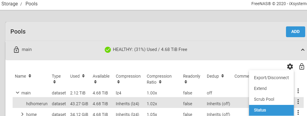

Samuel Tai
Apr 24, 2020
5,399
Go to Storage->Pools, and click the gear icon. Pull down to Status:
This will bring up the pool status, which will tell you the faulty disk.

Samuel Tai
Apr 24, 2020
5,399
It could be ada2. Also run a smartctl -a on ada3. The scrub is complaining about 4 corrupt files in your NealsHddVolume/windowset dataset:
NealsHddVolume/windowset:<0x2f628>
NealsHddVolume/windowset:<0x2f62e>
NealsHddVolume/windowset/3d prints before start script update 1-19-2020/Hue covers/stealthdecora2gang/obsolete/stealthdecora2standoff.factory/<xattrdir>
NealsHddVolume/windowset/3d prints before start script update 1-19-2020/Hue covers/stealthswitch2gang
The first 2 are so corrupt, even the names are gone. You'll need to pull everything off this dataset, remove the dataset, recreate it, and restore its contents.
