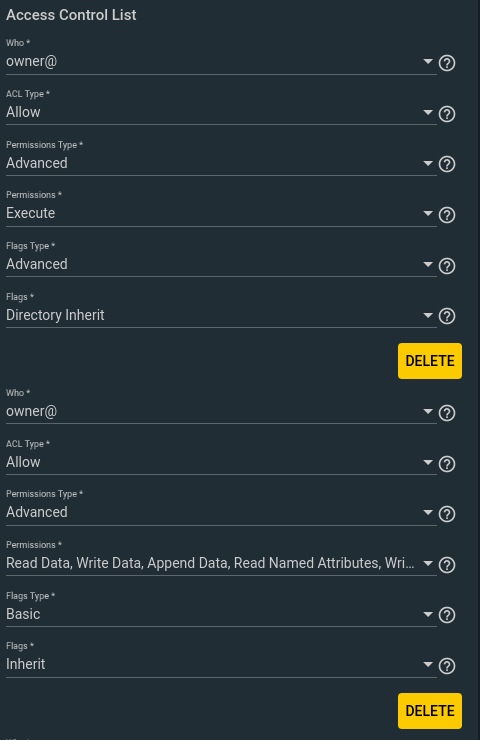

You need a slightly more complex set of ACLs in this case. For example:
group:restricted_group:x:d-----:allow
group:restricted_group:rwpDdaARWc--s:df-----:allow
muppet_3000
Aug 5, 2020
3
Hi, thanks again for your help on this, that has indeed cracked it (I had to add the same setup for my owner@ and group@ as well).
For anyone else stumbling across this in the future here's what my acl's for the directory now look like:
root@freenas[/mnt/storage]# getfacl test_restricted
# file: test_restricted
# owner: root
# group: restricted_group
            owner@:--x-----------:-d-----:allow
            owner@:rw-pDdaARWcCos:fd-----:allow
            group@:--x-----------:-d-----:allow
            group@:rw-pDdaARWc--s:fd-----:allow
group:restricted_group:--x-----------:-d-----:allow
group:restricted_group:rw-pDdaARWc--s:fd-----:allow
         everyone@:--------------:fd-----:allow
Thankfully the GUI reverse engineered this for me so I now know how to replicate it in the GUI for other datapools. Essentially each of the above lines needs it's own ACL entry in the datapool ACL page which roughly translates as follows:
These are the two entries that translate to the "owner@" lines in my above code snip. The "permissions" that are selected on the second entry are: absolutely everything, apart from "execute"
You then rinse and repeat this for "group@" and "group - <targeted group name>".
