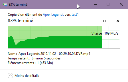

The upgrade went well, but I've noticed several slow down on the webUI and with my SMB share.
I thought this was the ZFS pools upgrade that maybe caused it, so I've backup, reinstall and create news pools on Freenas 11.3.
The problem persist, the UI was still slow, and my SMB share were quit "lagy" weird.
I can use them, but with strange behavior. It will copy for a few second at 110Mib/s, then almost stop for a few sec, and start again at full speed....
On all copies this append, each time the same dip
My question is: do this behavior could be caused by my old cpu Pentium G3220, this processor do not have AES-NI.

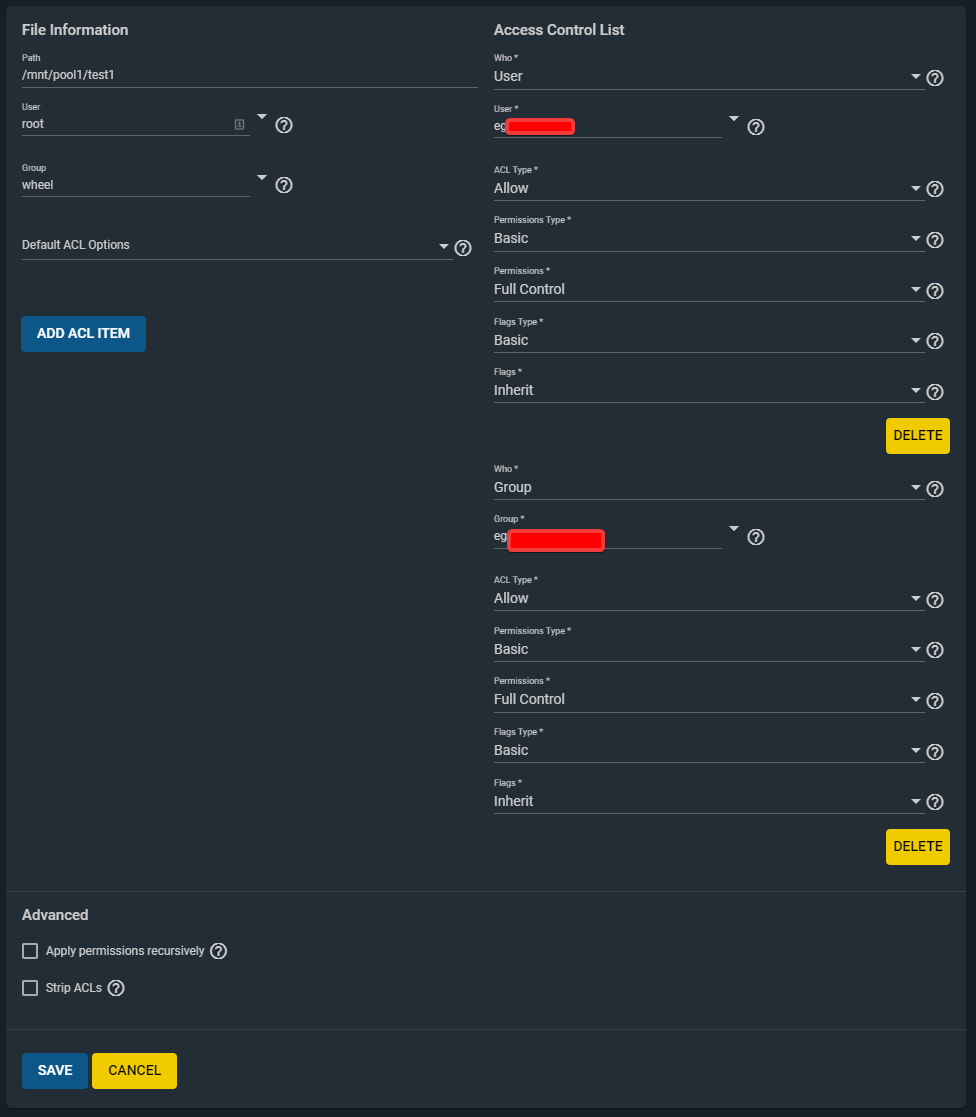

But I have some issues with Freenas 11.3 ACL permission with CIFS on Centos 7.
Centos create folder with extra permission and users, wheel & everyone.
my CIFS mount : \\192.168.0.1\media\Video /mnt/freenas/media/video cifs user=XXX,password=XXX,vers=3.0,uid=1001,gid=1001,iocharset=utf8,nounix 0 0
(cred will be used after)
And my ACL on Freenas.
