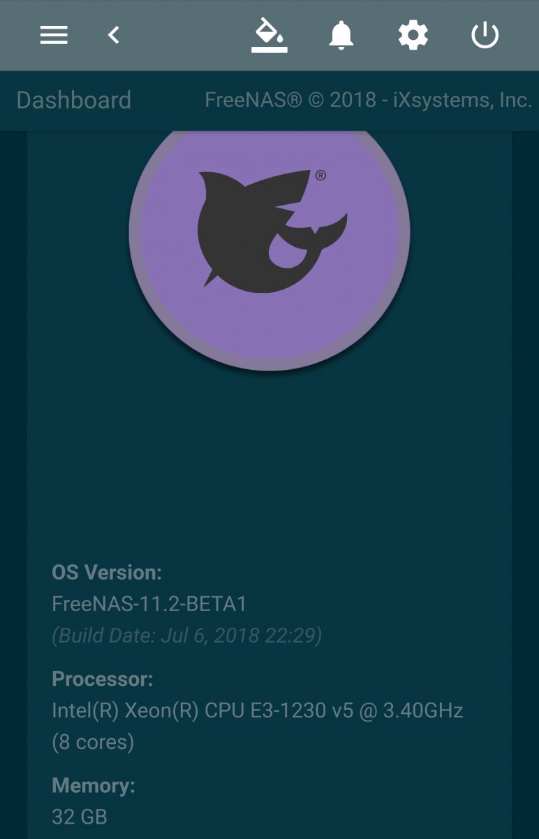

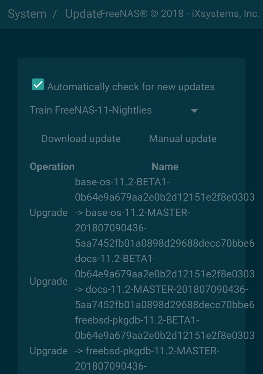

I made the switch today to 11.2 beta 1 though the cli (was on nighlies) but having a gui issue.
Gui shows I'm on 11.2 beta 1 but the updates section is saying I have updates for nightlies.
Sorry for phone pics.
