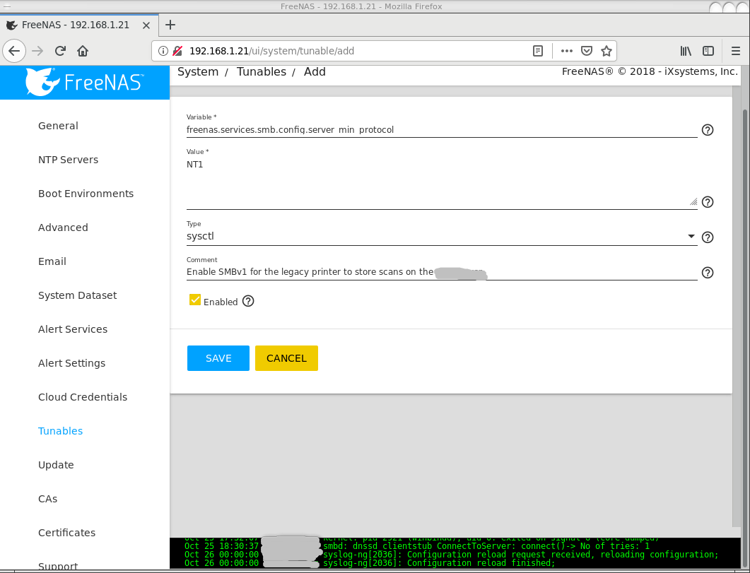

The troubleshooting guide at /docs/services.html#smb says "verify that Server maximum protocol is set to SMB2." but I cannot see that in the UI. The smb4.conf config file shows "server max protocol = SMB3" so I would like to try changing that to SMB2. The UI tooltip for auxilary parameters mentions smb5.conf but I do not have that. Adding auxiliary parameters on the share "server max protocol = SMB2" does not fix the problem. Adding it on the server level does not overwrite the parameter but adds it later, the problem also still exists.

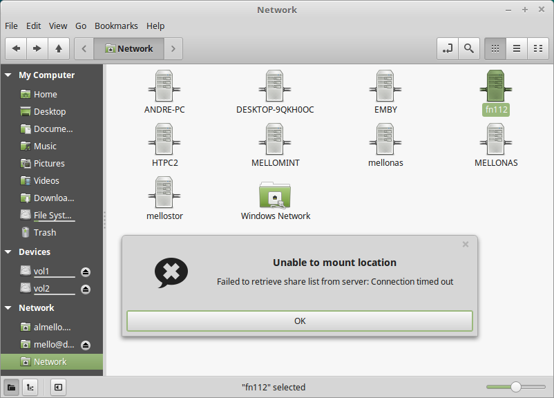

If I try and open the share with a Linux box using nautilus it works!

If I increase the log level I see "no protocol supported" as well as "pid_to_procid: messaging_dgm_get_unique failed: No such file or directory". If I set "server min protocol = SMB1" it does not help. Here is the log:
Requested protocol [PC NETWORK PROGRAM 1.0] Requested protocol [MICROSOFT NETWORKS 1.03] Requested protocol [MICROSOFT NETWORKS 3.0] Requested protocol [LANMAN1.0] Requested protocol [LM1.2X002] Requested protocol [DOS LANMAN2.1] Requested protocol [LANMAN2.1] Requested protocol [Samba] Requested protocol [NT LANMAN 1.0] Requested protocol [NT LM 0.12] reply_negprot: No protocol supported ! Server exit (no protocol supported )
