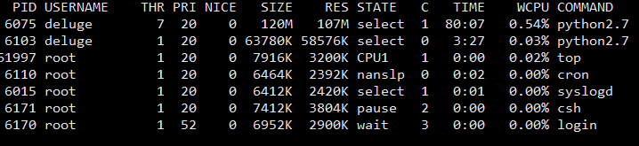

- Made sure deluge was running as user "deluge"

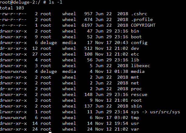

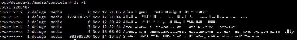

Yet, I can not see the folders and files deluge creates from the freenas side but I can see them inside the deluge cage, inside the /media/ mount. I have been playing with the permissions on the downloaded folders and files to no avail. Nothing shows on the freenas side.

It seems from what you describe that /media inside the jail is an existing and non-empty directory (which would mean the nullfs mount fails when it attemps to take over that directory, leaving you with all your files in the jail instead of the mounted directory outside it. Usually this stops the jail from being started, so maybe that's something new.
I would suggest stopping the jail, copy all the files out from the /media path to the /mnt/ssd/downloads path... then clean out the /media path and start the jail... see how that goes. (you may want to look at permissions before and after to make sure things will still work).

I kinda figured that might be the problem. Just made a dir in the jail and couldn't see that in freenas. Made a dir in freenas and could see that in the jail. Changed ownerships around a bit but that didn't help at all so I figured it's not privileges.
To be specific, because I am not an expert in mountingpoints at all, before you try to fstab a mountpoint, does the folder in the jail need to exist first or not? The 'media' folder in which I mounted already existed before I mounted something in it. Should I use a subfolder in media to mount stuff? What do you mean by cleaning? Remove everything in it or, to be thorough, just remove the media folder altogether and recreate?
What should I have done in the first place to avoid this?
9,700
It should exist, but be empty. Recreate it if that's simpler.
Check the jail structure and see if the target exists or not and if it's empty. (read the documentation)

I first unmounted, then deleted everything and remounted. Magicaly everything reapeared :O. I then first deleted everything, unmounted and recreated the mount. It is working as it should now. Solved.
