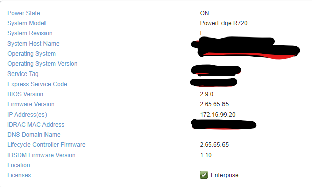

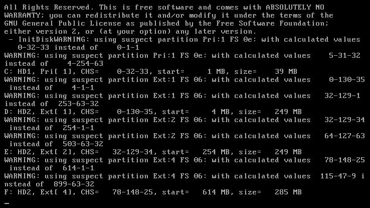

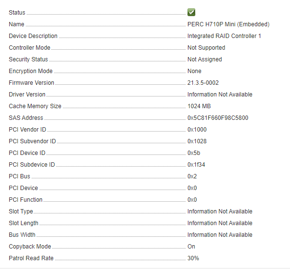

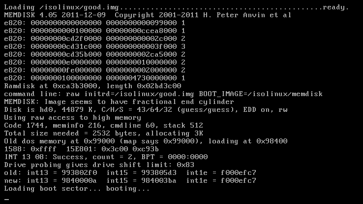

Trying to flash the H710P. Using the introduction instructions, I've attempted to boot the deesh-freeDOS-v1.9 on a R720. the H710 is the not the PCIe version so I cannot move it to another device.
When trying to boot the iso, weather it is via USB using Rufus, Ventoy, or virtual CD/DVD via iDRAC, the boot fails at either one of the following screens listed below. I have waited for roughly an hour at each screen before rebooting and retrying. I was able to load up the deesh-linux-v2.0 but I did not proceed with anything until I completed step 1. I'm only posting here on TrueNAS forums because I know @fohdeesha is on the forums. I'm using the latest download link posted on the introduction page.
The R720 has the latest 2.65.65 firmware and all other hardware / bios / firmware based off of the Lifecycle update.

Just as an update, I was able to go to freeDos's website and boot off of the FreeDOS image there using virtual media and an USB drive. However, I do not know the commands to find the "info" as posted in the Fohdeesha introduction page.
Is there an older version of the deesh-FreeDOS-v1.9.iso someone could link me to and I could try?
