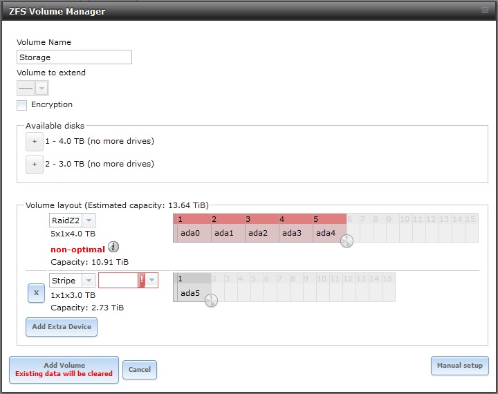

I've tried making one volume from 5 4Tbs on RAIDZ2, and I get "non-optimal" as you can see. Most likely because it puts the 5 4TB disks in
a vdev (not sure...) and stores the 3TB disk on a separated one. In the doc it says 6 disks are the optimal config for RAIDZ2.
Is there a way to squeeze in the 3TB in the RAIDZ2 as well? Apologies for my n00b questions that you have to cope with.

Yes. Click that "manual setup" button and put them all in there. It will shrink your pool temporarily, but you'll get the disk space back when you replace the 3TB drive.
cyberjock
Inactive Account
Mar 25, 2012
19,525
It didn't exactly offer it. It initially offered the 5 disk pool. Then the user probably "added" the 3TB, and it did it as a separate stripe because you've made selections that are already non-optimal.
The volume manager basically does a bunch of things, and as soon as you start deviating from its recommended configuration, then everything falls apart.
