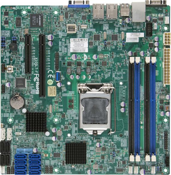

Thanks for your input everyone - and as one last (and I promise, it IS last!) request, what are the implications of this mobo:
Supermicro X10SL7-F - what would the implications of having effectively an LSI2008 (I think) on the MOBO? would I just flash it into IT mode and connect SATA drives as usual?
Sorry, that question made me think that was the board of choice.
