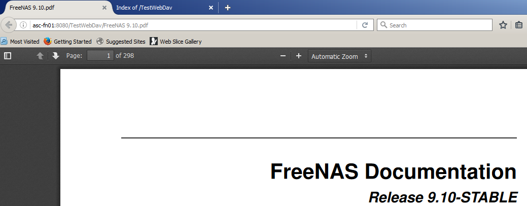

I just gave this a whirl and it appears to work fine (however it does prompt for a User Name and PW)...
By default these are:
User: webdav
PW: davtest
Keep in mind you need to specify the port in the URL (8080 is the default that is set).
Example: http://ASC-FN01:8080/TestWebDav

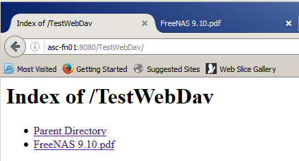

  • Did you configure a WebDav Share in FreeNAS?
  • Is the WebDav Service running on your FreeNAS box?
  • Are you using the default configurations for WebDav or did you change things (like https, etc)
  • Try going to the WebDav Share via URL first; excluding the PDF file to see if you can at least get to the Shared Directory first
Finally, just to be sure, you did review and follow the instructions for WebDav provided in the Manual I linked previously correct?

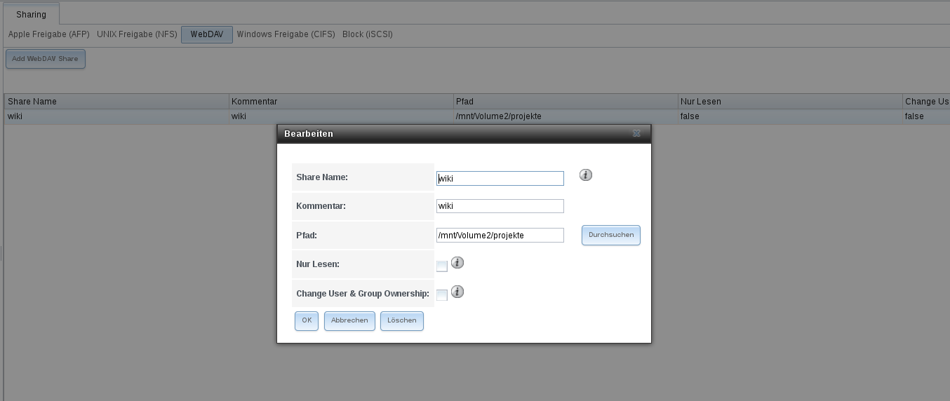

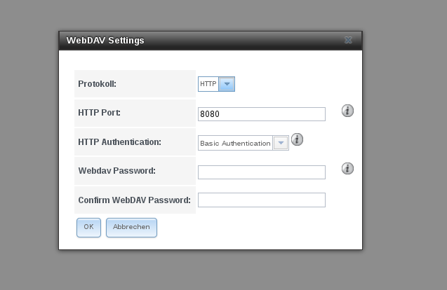

* Yes, i had configure a WebDAV Share in FreeNAS
* Yes, it is running
* Yes, i'am using the default configurtaion of WebDAV
* Share-folder is not reachable...
See the Pictures bellow the configuration.

Your URL is incorrect... the format is:
http://%Server%:8080/%WebDav_Share%
In my example (http://ASC-FN01:8080/TestWebDav):
  • "ASC-FNo1" is my FreeNAS Server Name
    • Which is resolvable by my DNS
    • That is why I recommended you try IP Address instead (I don't know if your DNS is resolving for you)
    • Is "axxfile" the name of your FreeNAS Server?
  • "TestWebDav" is the WebDav Share Name I used
    • Yours is "wiki" so you should use that..
Assuming that "axxfile" is the name of your FreeNAS Server (and it is resolvable by your DNS); then the URL you would want to try would be:
http://axxfile:8080/wiki
Try that manually in a web browser first; just to be sure you can get to at least that part...
