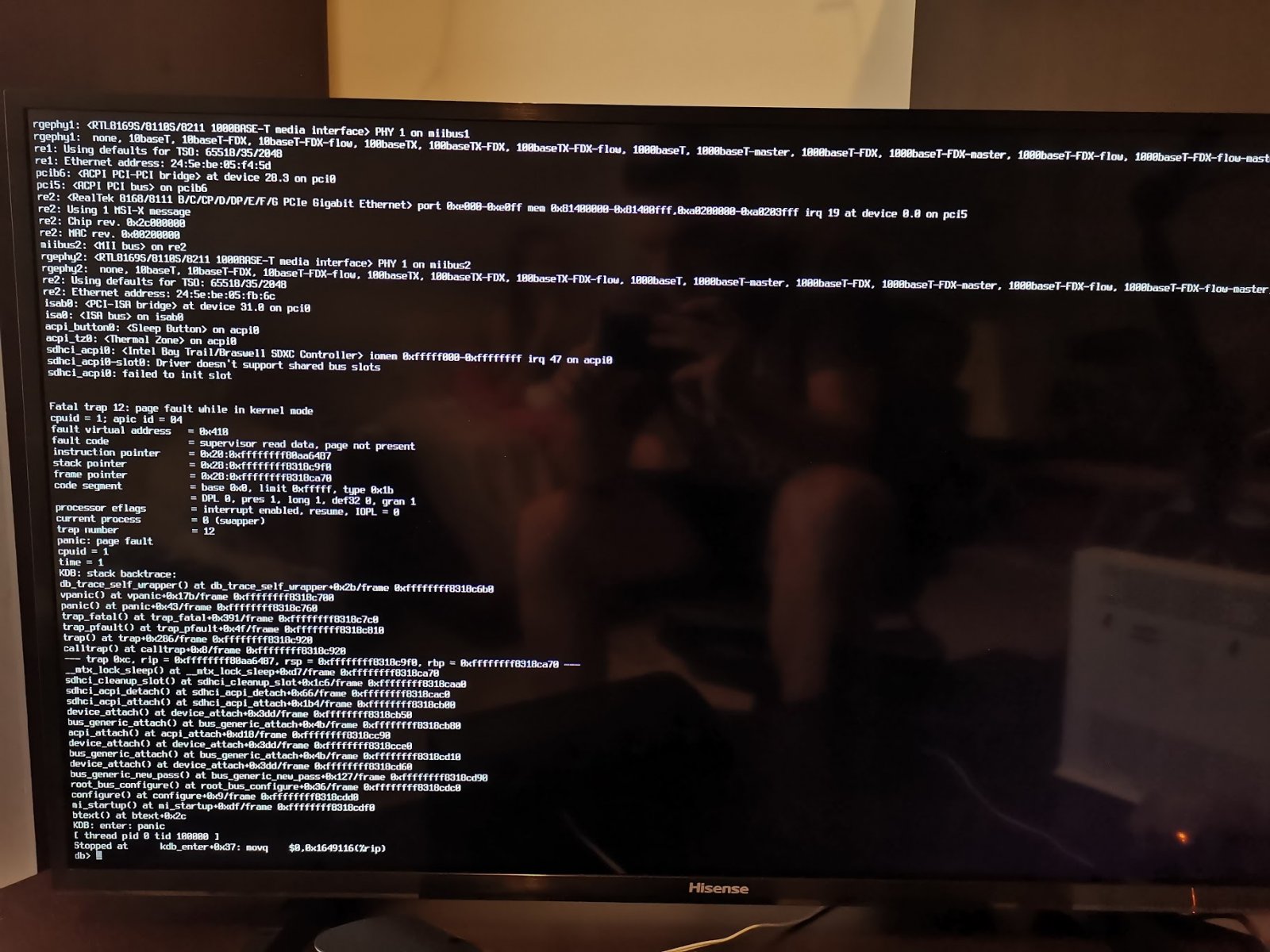

Fatal trap 12 on first boot after installing TrueNAS 12.0-U4 on QNAP TS-251A
m3nthal
Jul 3, 2021
5

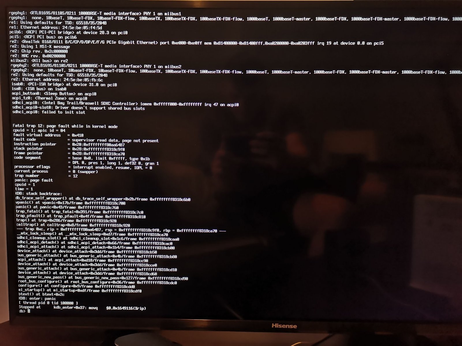

I've installed TrueNAS 12.0-U4 to USB Stick on QNAP TS-251A and get the following error after reboot:
Could this be because of RAM? QNAP TS-251A has only 4Gb. If so, will adding more RAM solve the issue?
Thank you

Yes, I know it needs 8Gb, but does this error mean insufficient RAM or something else?
Yes, it means insufficient RAM.

I tried booting into debug kernel and it loaded fine. Then I was able to boot to default kernel after reboot.
