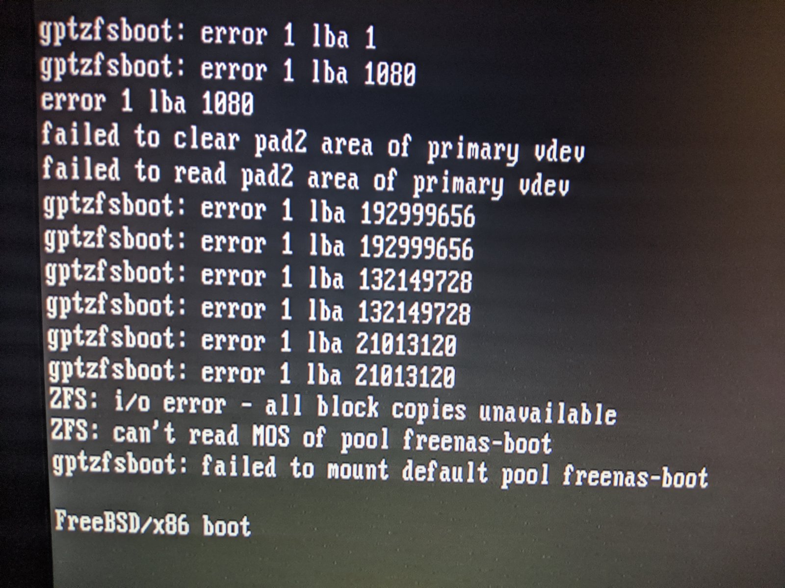

Hey All,
I've got 9 Samsung SAS SSDs (p/n: MZ6ER200HAGM-00003) and whenever have *any* plugged in, I get the below messages. I hot-plugged the drives and created a z2 pool, but the issue persists. Any insights what's going on here? I've got 3, LSI SAS2008 cards connected to my 20 drive backplane, and an existing z2 pool (where feature updates are pending) of 10 disks on a fully up-to-date FreeNAS-11.3-RELEASE system.
gptzfsboot: error 1 lba 1
gptzfsboot: error 1 lba 1080
error 1 lba 1080
failed to clear pad2 area of primary vdev
failed to read pad2 area of primary vdev
gptzfsboot: error 1 lba 192999656
gptzfsboot: error 1 lba 132149728
gptzfsboot: error 1 lba 21013120
ZFS: i/o error - all block copies unavailable
ZFS: can't read MOS of pool freenas-boot
gptzfsboot: failed to mount default pool freenas-boot
FreeBSD/x86 boot

The searching I did says that it seems to be related to FreeBSD querying all drives, and throwing a minor fit if something doesn't have a valid partition table. Check to see that your SAS2008's aren't trying to flag them as bootable devices maybe if they still have their option ROMs - are your cards in IT mode?
Failing that, hotplug the SM1625s and secure-erase them to nuke any remainders of a partition table, then see if it boots again?

So, it's none of those things, but asking about IT mode reminded me that one of the three HBAs was extremely difficult to successfully flash into IT mode (no joke, it took two machines, three utilities and three OSes and to wipe out the IR firmware and get the IT firmware onto it and the other two cards were a breeze).
Long story short, I confirmed that the HBA in question had not been in use until I added the new drives, I swapped some cables around so I knew which drive bay went to which HBA, and tested booting adding one drive at a time. Every time I added a drive to the HBA in question, my boot issues reappeared.
So, looks like I'll be buying another SAS2008.
For anyone else in the future who is running into this issue, check your "Boot Support" setting (as recommended by HoneyBadger above) in the Avago Config Utility (ctrl+c at the prompt during boot). I suspect this setting is part of my problem here, but the utility refuses to load for me, presumably because of the bad card.

I don't seem to have powers to edit my initial post, but I also wanted to add that FreeBSD does begin to boot (the text based spinner blips on the screen for a second) before spitting out the above messages.
