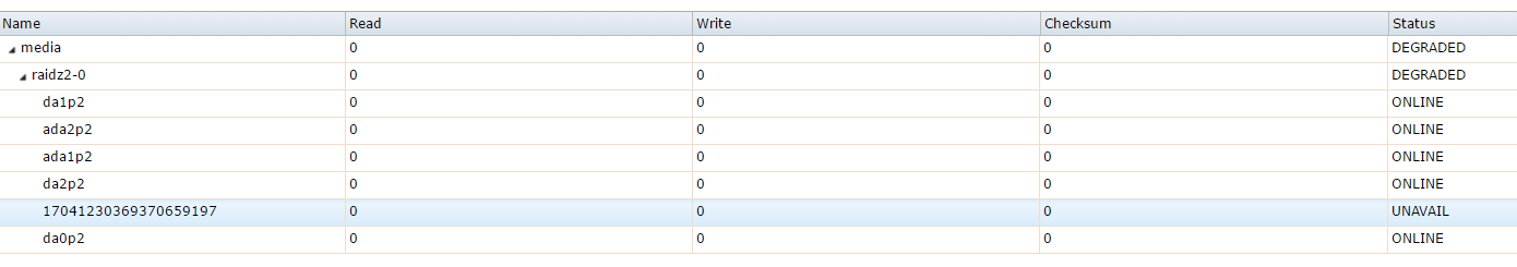

To be fair I did not follow the instructions.
I removed the old hard drive before taking it offline and now I am in the weeds.
The new HDD is installed and the replace routine rendered this....
Apr 1 21:26:29 freenas (da3:mps0:0:7:0): SCSI sense: UNIT ATTENTION asc:29,0 (Power on, reset, or bus device reset occurred)
Apr 1 21:26:29 freenas (da3:mps0:0:7:0): Retrying command (per sense data)
Apr 1 21:26:29 freenas (da3:mps0:0:7:0): READ(16). CDB: 88 00 00 00 00 01 5d 50 a3 49 00 00 00 04 00 00
Apr 1 21:26:29 freenas (da3:mps0:0:7:0): CAM status: SCSI Status Error
Apr 1 21:26:29 freenas (da3:mps0:0:7:0): SCSI status: Check Condition
Apr 1 21:26:29 freenas (da3:mps0:0:7:0): SCSI sense: ABORTED COMMAND asc:47,3 (Information unit iuCRC error detected)
Apr 1 21:26:29 freenas (da3:mps0:0:7:0): READ(16). CDB: 88 00 00 00 00 01 5d 50 a3 49 00 00 00 04 00 00 length 2048 SMID 401 terminated ioc 804b scsi 0 state c xfer 0
Apr 1 21:26:29 freenas (da3:mps0:0:7:0): Error 6, Retries exhausted
Apr 1 21:26:29 freenas (da3:mps0:0:7:0): Invalidating pack
Apr 1 21:26:29 freenas notifier: swapoff: /dev/da3p1.eli: No such file or directory
Apr 1 21:26:29 freenas notifier: geli: No such device: /dev/da3p1.
Apr 1 21:26:29 freenas manage.py: [middleware.exceptions:37] [MiddlewareError: Disk replacement failed: "cannot replace 17041230369370659197 with gptid/aa9821e1-f871-11e5-9078-00045fb29a7a: one or more devices is currently unavailable, "]
Any guidance would be appreciated....

To add to this mystery, consider the following about my new hard drive during a replace via GUI
Apr 11 23:32:04 freenas (da3:mps0:0:7:0): READ(6). CDB: 08 00 02 00 10 00
Apr 11 23:32:04 freenas (da3:mps0:0:7:0): CAM status: SCSI Status Error
Apr 11 23:32:04 freenas (da3:mps0:0:7:0): SCSI status: Check Condition
Apr 11 23:32:04 freenas (da3:mps0:0:7:0): SCSI sense: ABORTED COMMAND asc:47,3 (Information unit iuCRC error detected)
Apr 11 23:32:04 freenas (da3:mps0:0:7:0): Retrying command (per sense data)
CallSteward
Apr 18, 2015
12
The new drive attached as a spare and shows up as a possible replacement, but it will not replace the old drive.
