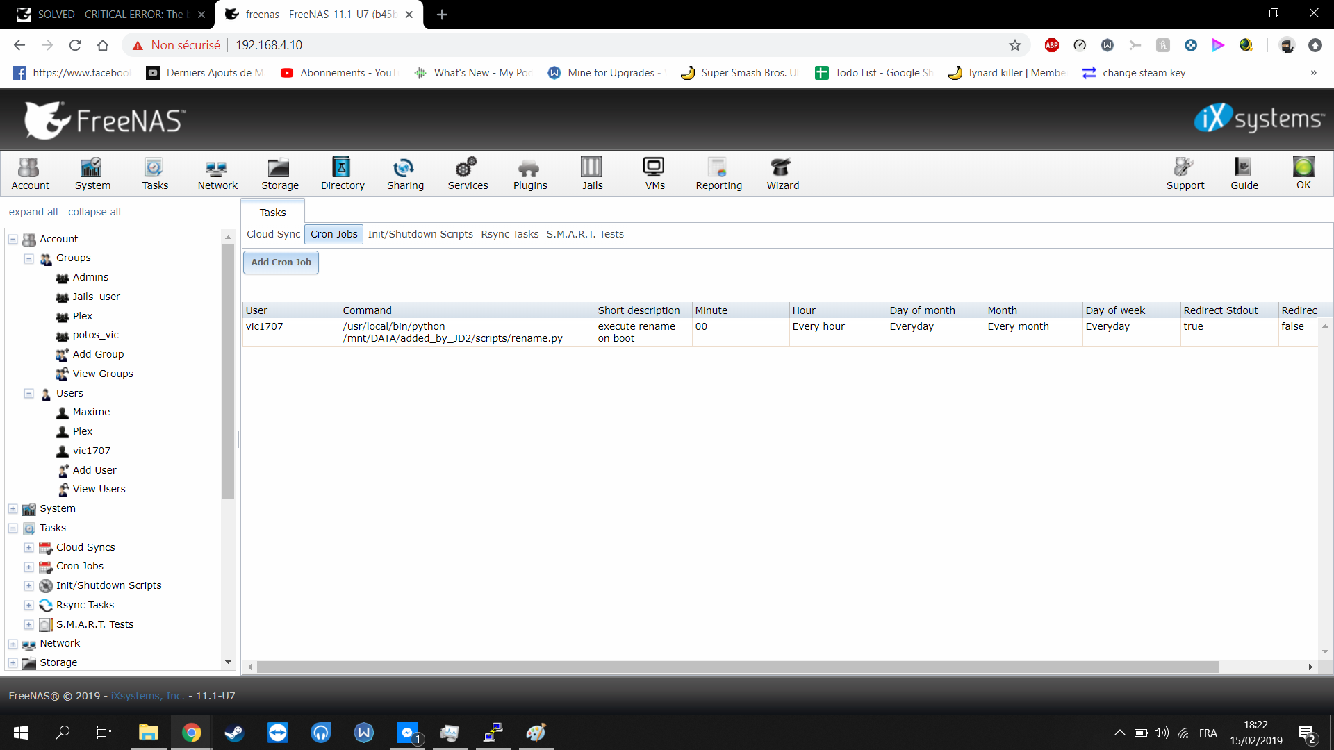

vic1707
Jan 28, 2019
46
thanks, so i didi this, for the hours minutes day ect... what should i set?
Apollo
Jun 13, 2013
1,458
It seems the script should run every hours.
If in doubt, you want to create a script that will run something simple and can be checked easily like creating a file and writing to it.
From memory, "Redirect stdout" could have a side effect on scripts. Can't say what exactly. You need to experiment.
You can also increase the recurrence to every 5 minutes and see how it works.
You can also request to run the cron job manually too, I think.
