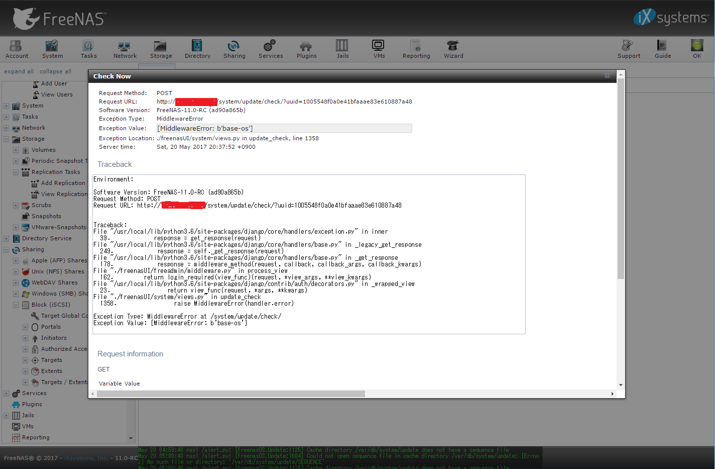

Hi guys,
While upgrading FreeNAS11 RC1 to RC2, i got error as following,
someone have the same issue ?
My FNBox:
ASRock C2550D4I MiniITX
CFD DDR3 PC3-12800 CL9 32GB
WD HDD 2TB Blue WD20EZRZ/AFP / 5,400rpm / SATA3.0 x 7
Boot Disk SANDISK SSD Plus 120GB
Thanks for any advice.

Unfortunately these types of errors do occur when the software is in this state, being beta. This should not occur during the Release versions. The solution is install from ISO.
Well, you should never get a traceback, so please file a bug report and include as much detail as possible.
FWIW, my RC1->RC2 upgrade was painless.
Hum... I've recieved these many times during beta upgrades and then a note comes out to update via the ISO.
Well, the updater hasn't changed and really should work, especially in the RELEASE branch.

I just rolled back to 11.0 RC and updated to 11.0 RC-2, no issues but it's just a basic load, nothing fancy going on here.
This is a release candidate. This should not be in a release, and should get reported as a bug.

Hi Guys,
Thanks for all of your advices.
Today (27/5 JST), I completed to upgrade FN11 RC -> RC3. (not RC2)
This issue was closed here.
