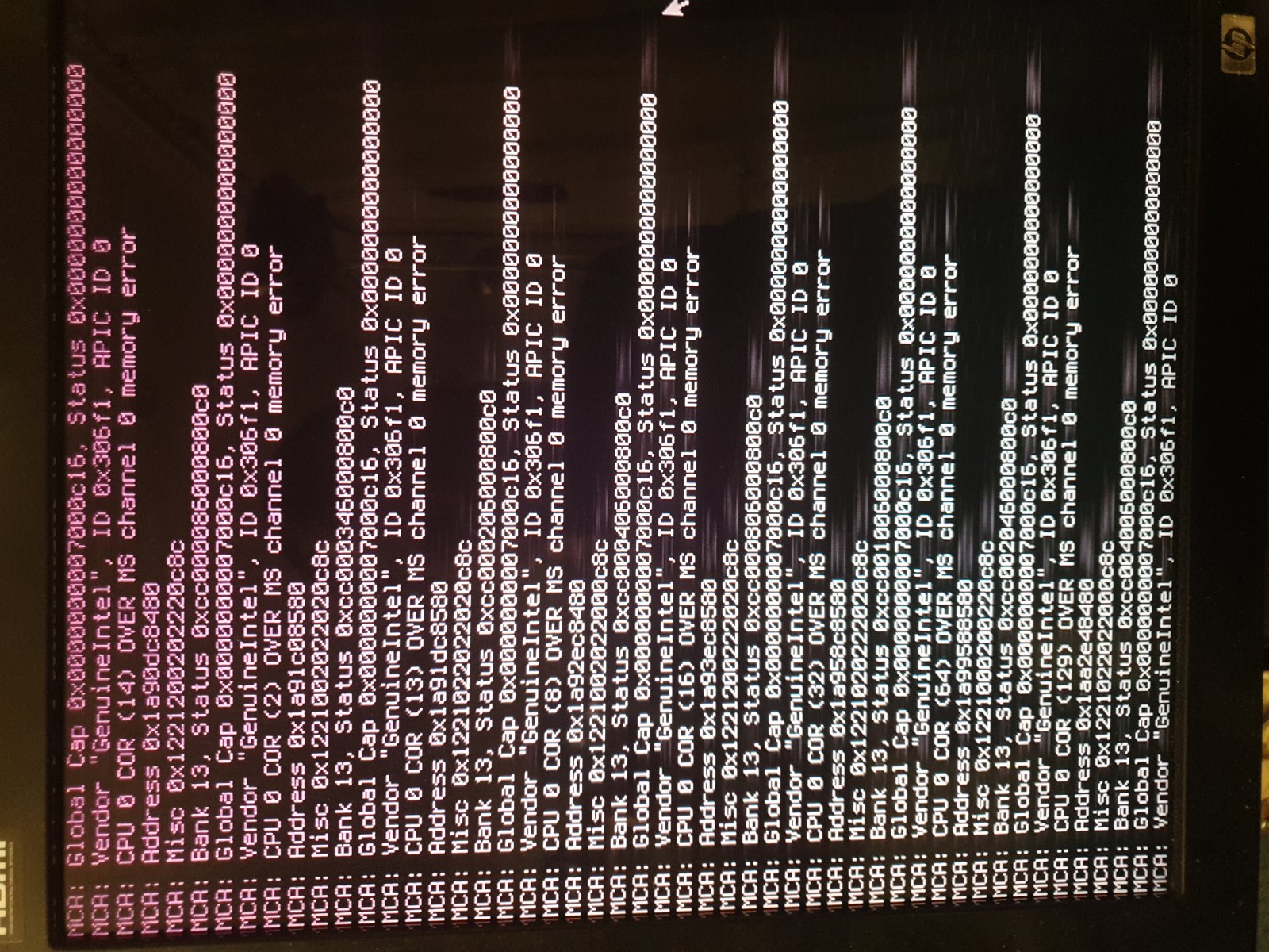

My console dumped pages like this. Its clear its about memory or memory controller, not obvious what exactly the issue reported is, how to.interpret it, whether its a warning or a hard problem, whether to just reseat RAM or replace it or swap sticks round to test controller,etc.
Help requested, thanks!
Not sure why it's sideways but still... !!

This is telling you that the machine thinks one of your sticks of ram is bad. 0x306f1. The easiest way is to run a lot of memtest. For like a day or so (if can). Youll find out much sooner than a day if the ram is bad, lots of times youll get errors within the first pass or three if its bad. Any errors are bad news, however, i have seen these RAM bug a boos alot over time, and in several (not all) cases a RAM reseat will likely "fix" it.
So if its me id do something like this in this order.
Make a USB disk of memtest it comes on several popular linux "boot" disks ready to go.
Shutdown my TN server remove power.
Pull all ram sticks and reseat them one at a time. (Air duster? Absolutely.)
Boot up the linux memtest USB. In my experience if your ram is bad bad youll get errors very near immediately. But i have found errors deep into many passes. Let run as long as your willing. If you can make it to three passes error free Id try booting TN back up and watching close for more error.
Can the output identify which stick, or channel, it thinks is suspect, and what exactly was detected?
Or,if easier,what does that output actually say at a technical level, decoded and not simplified down to "memory error"? How do I read the lines?

I * think * I now understand what's going on, but its a bit of a reach, I wouldn't mind a sanity check. Also this may help others, so I'll detail how I got there.
I was guided by google searches for stuff like FreeBSD MCA GenuineIntel (with slight variation for whatever AMD CPUs show up, if needed) which led me to this thread in particular, and also this one.
TL;DR version: mcelog will dump the error messages, but for me at least wouldn't decode the actual DIMM reference. dmidecode appears to provide the link, but I would really like my understanding checked.
Data output from mcelog and dmidecode:​
Neatened mcelog output (removing obvious stuff that wasn't helpful):
MCE 0 BANK 8 TSC 184c510777e37a MISC 50525286 ADDR 1b93f085c0 STATUS cc00054000010090 MCGSTATUS 0 MCGCAP 7000c16

Most but not all, are "corrected patrol scrubs", suggesting they were fixed internally.
Also if ADDR is the memory address of the error, then all errors occur in the range 0x01A00000000 to 0x01CFFFFFFFF.
I followed the hint from the post linked above, and used dmidecode to try and identify the exact DIMM. I found that dmidecode lists memory twice - once as purely physical devices, then again this time as memory mapped devices. It also split them into 2 groups of 4, each time (my board has 8 slots). So here are the relevant 4 chunks.
Physical devices - part 1 of 2. Device with handle 0x002B "contains" 4 x 32GB DIMMS with handles 0x002C-0x002F:

Memory Device Mapped Address
