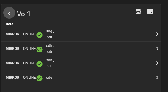

Greetings.

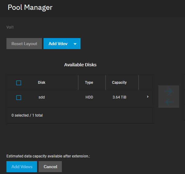

I noticed today that one of my drives is missing from one of the vdev's in the pool. I have/had four sets of mirrored disks in the setup (8x4TB drives). The dropped? drive does show up if I attempt to add a vdev, but cannot add it as a mirror - obviously because two drives are required.

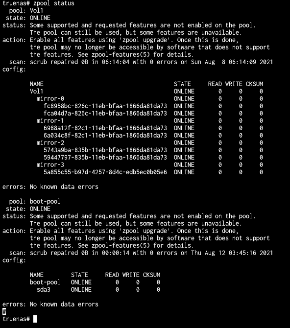

zpool status appears to show the same thing:
How do I get this drive back in the mirrored set? Is it as simple as clicking on "extend" under mirror actions for that vdev? I just want to be sure before doing so as I'd like to not cause any further issues.

In CORE I would write: yes, just click "extend", but I don't know if that works in SCALE and what possibly could have detached the drive from your mirror.
If you want to do it on the command line you can do a zpool attach <pool> <old drive> <new drive>.
"old drive" is the uuid you see in your zpool status output above. "new drive" is the full device path in /dev/diskbygptid or something similar I don't know from memory right now. If you are familiar with Linux, you will find it.

I'm not sure why it would have detached but in any case, I clicked on extend and now it is running through the resilvering process. I don't understand why SCALE would say that the array was healthy though...
Looks like it is running quick though...
Oh, well it's done already. So, extend does it.
Thanks!
