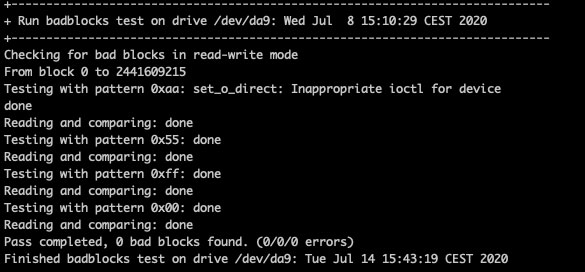

I recently replaced a disk in my pool after I received the following alerts:
* Device: /dev/ada3, Self-Test Log error count increased from 0 to 1.
* Device: /dev/ada3, 8 Currently unreadable (pending) sectors.
After replacing I run Sparefoots burnin script to validate wether the old disk is really failing or not.
Bad blocks returned no errors and the short & long S.M.A.R.T tests all pass without error - which installs confidence in me that the disk is actually fine.
I have attached the results and would appreciate some help deciding if the disk would be fit for service again or not please.

  • burnin-WDC_WD100EMAZ-00WJTA0_1EG80W3Z.txt
