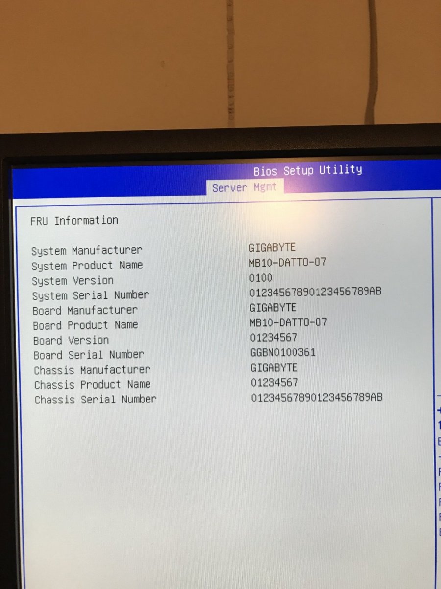

The hardware I'm using is a with 4 hot swappable HDD bays.

Does this look to be the same board:
https://www.gigabyte.com/us/Server-Motherboard/MB10-DS4-rev-13#ov
Most people build their own system for FreeNAS. Did this come with FreeNAS already installed? What made you think this hardware was compatible with FreeNAS?
My guess is that the chipset in this board is so new that it is not yet supported. You should probably put in a feature request and give the developers as much data as possible about the hardware so they can work to make FreeNAS compatible in a future release.
It is usually best to build with something that is not cutting edge because of the likely situation that new equipment is not yet supported with hardware drivers.

Beside the fact that the CPU is the same, it is not the exact motherboard. I think that the M/B is a specially, custom made for Datto, Inc.
The box is from 2015. Is that still too bleeding edge?
