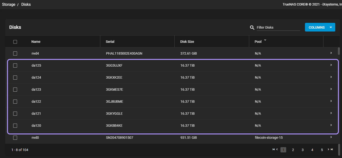

A terrible thing happened today. TrueNAS used the HDDs of one zpool in creating another...
As a result, the zpool that previously owned the three disks involved in the new zpool was damaged because it consisted of 2 raidz2 vdevs.
My mistake - I should have first figured out which three "extra disks" TrueNAS sees in the "disks" under "Storage/Pools/Create Pool",
which physically should not be there. Usually only disks not involved in arrays are displayed here. I trusted TrueNAS, I could not admit that it could dispose of the disks in this way, and three "extra" disks are some kind of glitch.
So my stupid question with an almost guaranteed known answer is: can I restore the raidz2 vdev (and thus the entire pool) in case of 3 drives failure/absence? May be there is any magic to "unformat" that 3 drives detached from the affected zpool in the process of creating a new zpool? Anything else? :oops:
But the next degree of mystery is this: now I should see only 6 HDDs available for zpool creation, but actually I see 15. What is going on? o_O
p.s. TrueNAS-12.0-U6.1

At the same time TrueNAS says in Storage/Disks that there are only 6 disks not involved in zpools!
I have a feeling you have multiple SAS paths and the devices were not handled by gmultipath correctly.
Can you dump gmultipath list in CODE tags?

HoneyBadger
actually does care
Administrator
Feb 6, 2014
5,112
It's too large to paste it here. https://pastebin.com/R9jQexk1
I'm not seeing a gmultipath record for any of the three failed devices by GUID from your pool - which unfortunately is dead because all three drives were in the same RAIDZ2 vdev.
gptid/f18dbd51-4dd5-11ec-807c-b49691b9a6c8  FAULTED      0     0     0  corrupted data
gptid/f2af844e-4dd5-11ec-807c-b49691b9a6c8  FAULTED      0     0     0  corrupted data
gptid/f292246d-4dd5-11ec-807c-b49691b9a6c8  FAULTED      0     0     0  corrupted data
gptid/f292246d-4dd5-11ec-807c-b49691b9a6c8     N/A  da73p2
gptid/f18dbd51-4dd5-11ec-807c-b49691b9a6c8     N/A  da93p2
gptid/f2af844e-4dd5-11ec-807c-b49691b9a6c8     N/A  da95p2
I can't find any of them in the gmultipath output. Were these SATA disks, potentially added after the initial setup - anything that makes them special or different from the rest of the ones in the pool?
Rabinovitch
Apr 3, 2021
43
Yesterday we removed all the SATA drives, with the entire NAS turned off. But these disks belonged to another array, instead of which a smaller one was created today. Existing pools were not affected during disk extraction. All the remaining disks are identical (WUH721818AL5204).
Well... Probably this issue has some relation with another problem we are experiencing with TrueNAS and AIC disks enclosures: https://www.truenas.com/community/threads/failed-to-boot-nas-after-upgrade-to-12-0-u4.93645/
I need to report a bug for it too...
But anyway - WHY don't TrueNAS consider some disks as other zpools' members but give the opportunity to select these disks when creating a new zpool? It shouldn't be like this...
