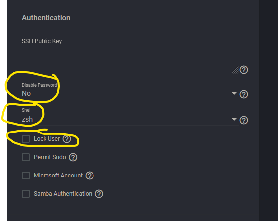

if we are just talking about disabling the password for the root account, that can be done in the user account settings (any user, really)
I don't have it in front of me right now, but I think there is both a checkbox to disable the password, and the option to select /nologin for the shell.
both would prevent root from doing..anything really.
you can also go into the SSH settings and block root from SSH login, or at least from password only root login. this would allow using ssh keys.
this is what I have set currently.

looks like you can just hit lock user. it says it cant be used with disable password. either would do it. one would prevent the account from doing anything, while the other would just prevent using the password to log in.

SOLVED!
Thanks @artlessknave! went to credentials -> root -> edit and used the toggle switch under "Edit User" to "Disable Password".
Worked like a charm. root can no longer log into the GUI but my admin user still can.
