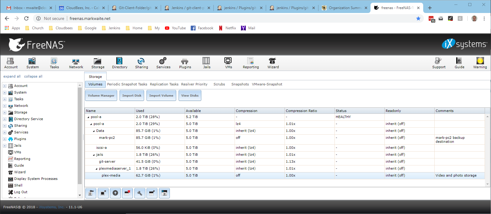

The "Storage" -> "Volumes" page looks like this:
I assume the problem file system is the highlighted one. It contains far too little information (62.7 GiB is too small for the media files that should be there), while its parent contains the right amount of information (1.8 TiB).
Unfortunately, I haven't found a way to remove the incorrect "plex-media" volume.
If that hunch is correct it may also explain that I'm wasting effort applying lz4 compression to media files that are already compressed in one form or another.
