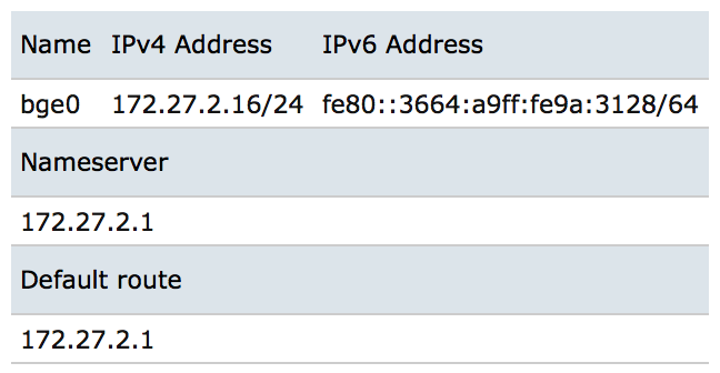

There is not even an IPv6 nameserver. There is no way how there could be one of course:
When configured for static IP but 'Auto configure IPV6' not set, then there is a nameserver entry:
Is this a bug?
