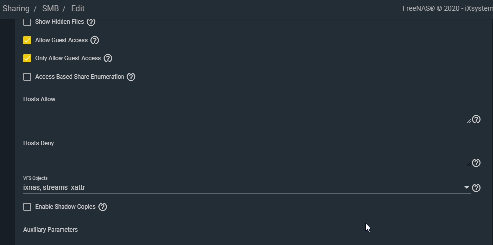

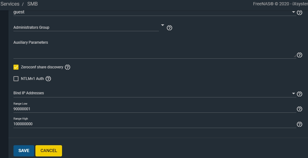

thanks for your reply.
9,703
OK, so you have "only allow guest access" ticked, so if you're trying to authenticate as anything other than guest, you won't be able to access the share.
Perhaps we can start with that and see where that takes us.
Did you do anything on the share or dataset to set permissions to anything other than guest yet?

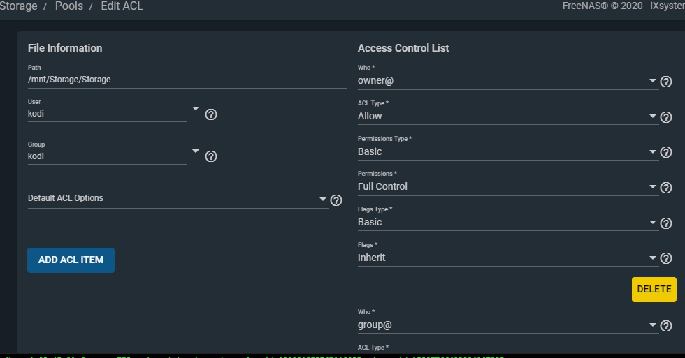

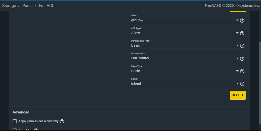

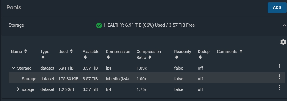

I did create a dataset on the Storage pool. and set the permissions to the user kodi and group kodi

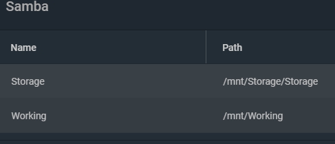

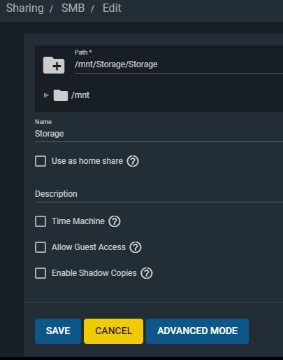

i tried this before but i got an error. here is the new smb share

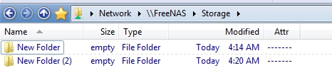

the problem now is the new share works as you can see but it did not ask for a password as i expected. i thought as i set the permissions on the dataset to kodi user and group i would have to use it's username and password
ethereal
Sep 10, 2012
762
hello again. i just want to be clear there is still a problem.
the share is not asking for a user name and password.
i still desperately need help from anybody with some suggestions
ethereal
Sep 10, 2012
762
i'm sorry it looks like my windows 10 was broken.
i did have Enable Insecure guest logons enabled.
i turned it off and on again. now windows 10 sees everthing including guest shares. looks like it was just my windows 10 that was broken nobody elses,
