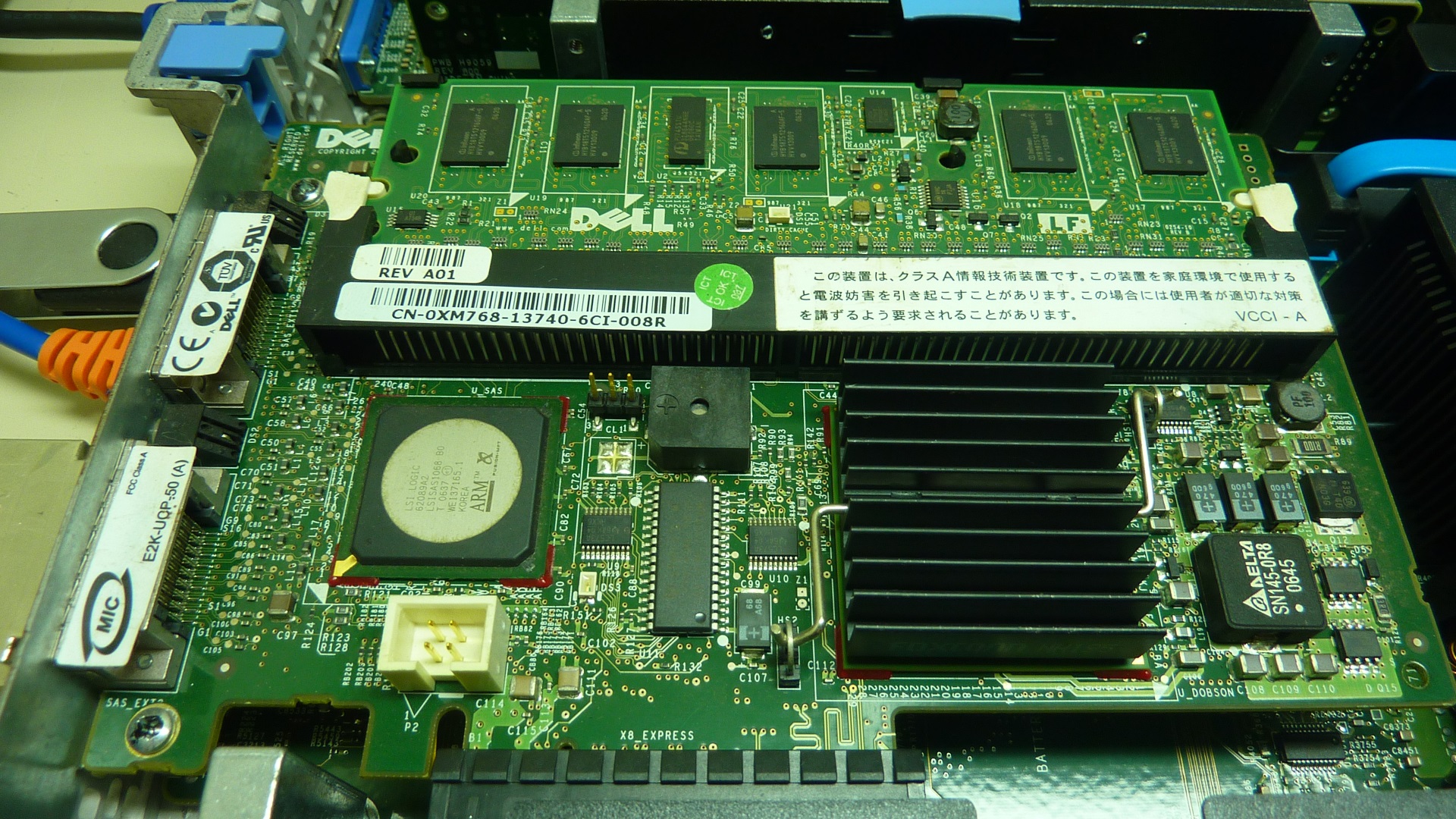

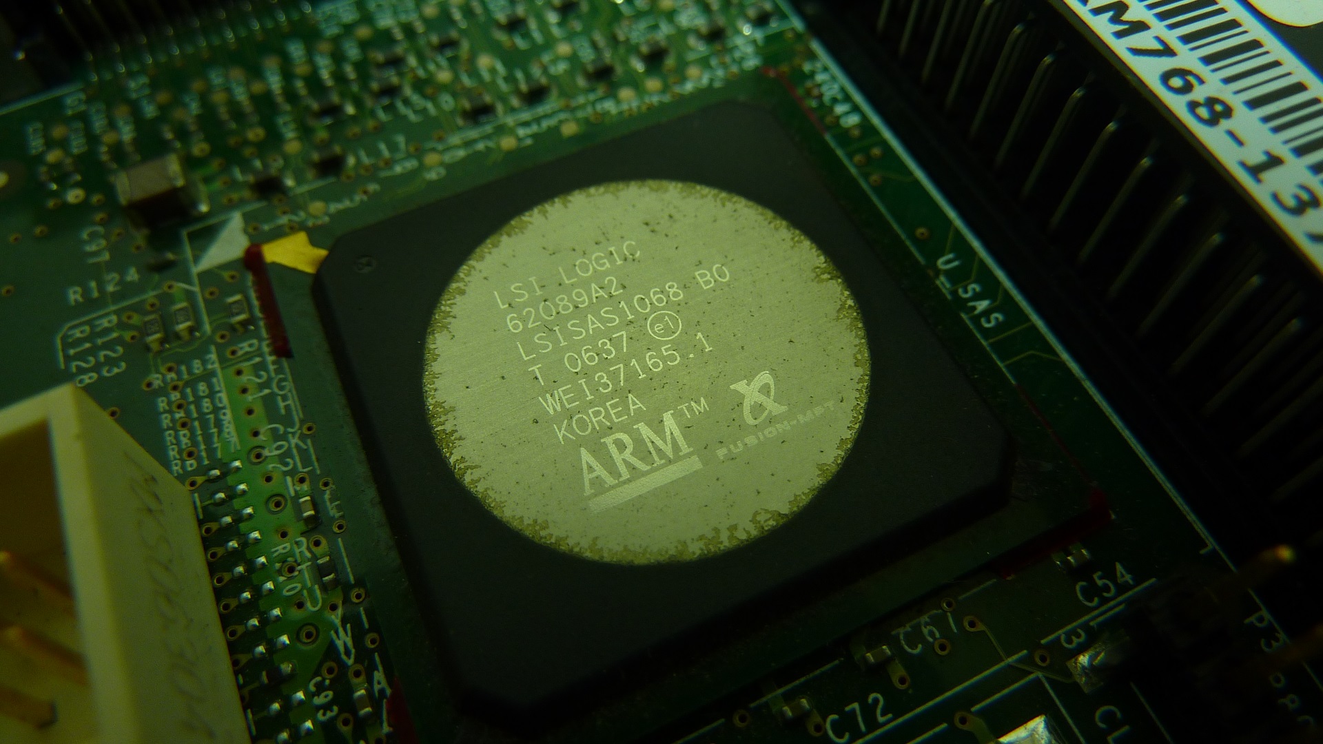

It seems to be, but there is a "SAS1068 B0" on the chipset. Anyway, it's a Dell PERC 5, so....not recommended.
Thank you!
If that's the case, it must be a SAS 5/e (different from PERC 5/e) which is a rebranded SAS1068. Here's a thread of a user on Overclock.net who successfully flashed LSI1068 IT firmware onto a SAS5/i (similar model, but internal SAS ports)
http://www.overclock.net/t/629200/flash-a-dell-sas-5-ir-with-lsi-firmware-not-a-perc
Note that this user had initial difficulties with the LSI ROM BIOS being too large for the Dell ROM chip (at least I believe that was the root cause) - so you may have to modify the flashing procedure.

Thank you for the tip! I'm a bit confused, but on boot it shows SAS 6/iR for the integrated controller (internal Dell 1950 drives) and PERC 5/e for the PCI-E Dell Adapter. I took some pictures of the adapter and the chipset:
