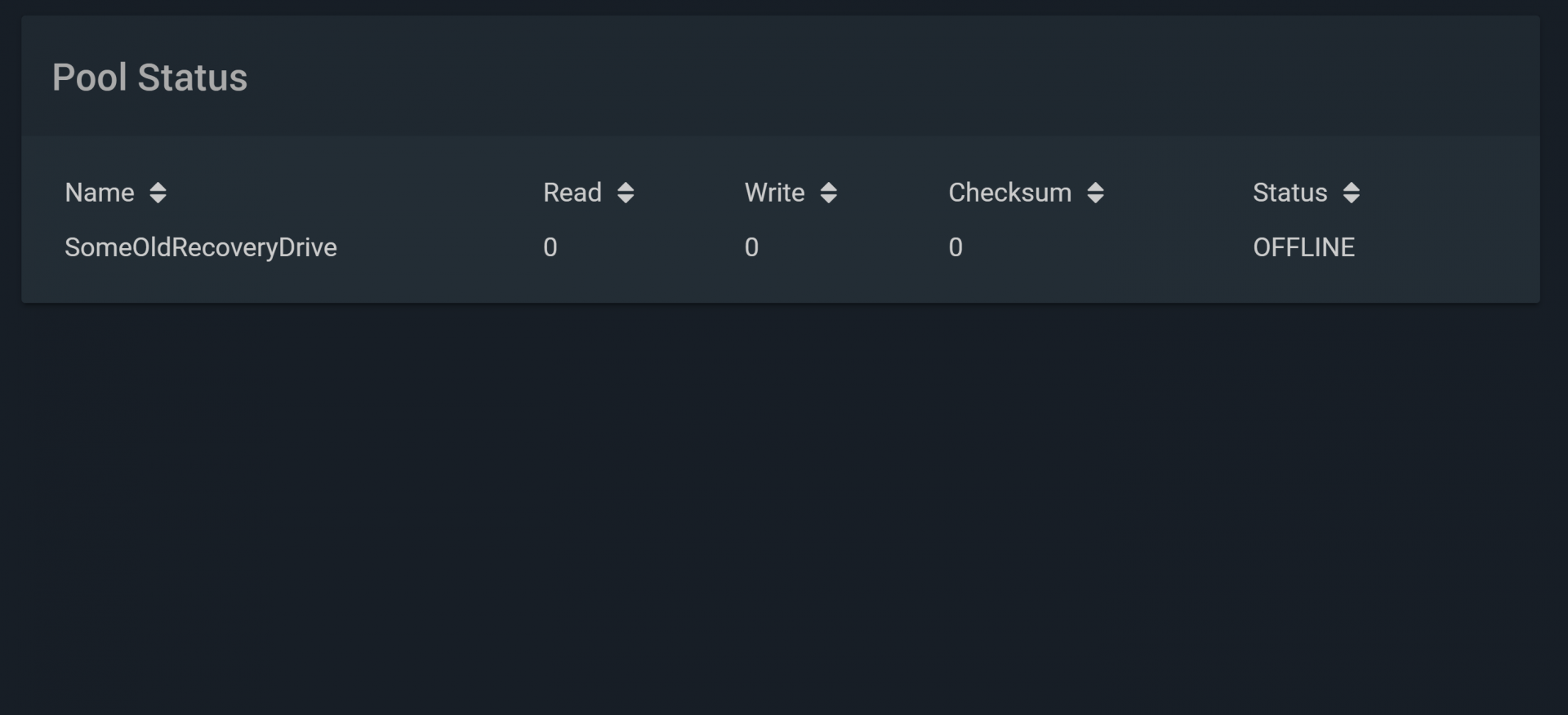

Here I've physically disconnected a drive from the system:
1. Can I see what configuration of the pool was?
2. How do I find some unique identifier for the drive, so I can easily replace without going through the process of elimination?
This was just a single drive pool, but you can't see that from the status of the pool... and I'm not going to remember in 5 years time...

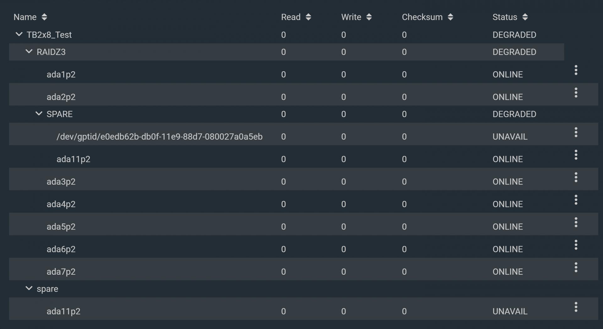

In this pool I've removed a drive and as you can see the hot spare has done its job...
Here at least I get something on the old drive... but why the difference between this and the first screenshot (here the unavailable drive is at least listed)?
Something like a notification reporting the serial of the troublesome/dead drive would be the obvious solution, right?
