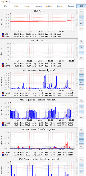

sfcredfox
Aug 26, 2014
340
Additionally, I noticed a change in the Memory reporting. Maybe this graph is only showing ARC and not total system memory?
