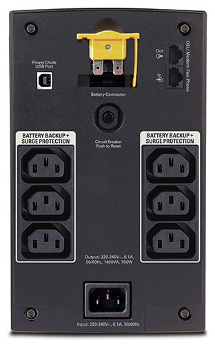

The back panel of the BX1400UI has two multifinction rj45 ports, those should do the job as far as I know, but, this would be my first time buying an UPS, let alone configure this functionality, so before spending money I'd really like to hear an opinion about these UPS from people more knowledgable than me.
I might be wrong, but I think that is just Surge Protection, and I think it's RJ11, not RJ45. At least if I read APC's support page correctly.

You can connect it via USB from the "PowerChute USB Port". That is what I did on the BR1500G.

You need to isolate all copper to the server, that includes the Ethernet cabling. So an adequate UPS needs surge protection on RjJ45 as well as power
Ok so basically the cheaper psu is usable with freenas and automatic shutdown, right? There are extra features that I can miss with this "basic" unit there are useful freenas-wise?
