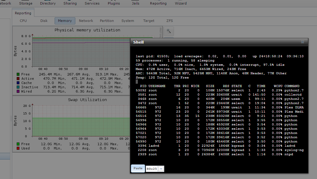

Here's a completely idle system with 8GB of RAM. It's a backup system, no shares. I installed plex just to see the RAM requirements. Plex isn't doing anything. And the nas isn't doing anything. I can't imagine dropping this to 4GB and expecting it to run.
Ansem
May 14, 2016
15
FreeNAS adds a layer on top of what the OS would normally need. So in addition to a healthy amount of RAM required for ZFS, you also have the FreeNAS middleware RAM requirement. And then you add in Plex (and you say a VM?).
Thanks a lot for you answer! i'll definitevely go for 8GB still an idle system with plex use a little more than 2GB of ram, why peole is telling me that for sharing a folder and using plex i need more than 3gb of ram? does plex and sharing folder use more than 4gb?!
