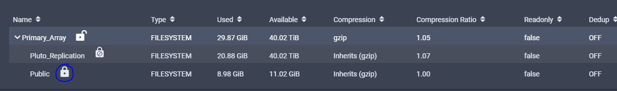

Thanks for coming back so soon. I tried the -w flag, and it does indeed copy the entire dataset (snapshots included), however the dataset on the Primary_Array appears locked? I tried unlocking with both the key for the Primary and Secondary array, but without success.
This is the command I used, does this look correct?
zfs send -Rvw Secondary_Array/Public@copy2 | zfs receive -F Primary_Array/Public
(Haven't had a chance to read your Pseudo-roots method article yet but will certainly do so, think I'll leave compression for now, as I really doubt I'll gain much from it.)
Oct 22, 2019
3,641
Since it is under a different pool, the .json file (which contains the keystrings for each encryptionroot dataset) will not match the new names. You can manually modify the .json file in a text editor, or just copy + paste the 64-character HEX string to unlock Public. After doing so, change Public encryption options to "inherit", so that it will use the same keystring/passphrase as Primary_Array, and it will be part of the same "encryptionroot". (This can only be done when it is currently unlocked.)
Every time, after you change an encryption property, enable/disable "inherit", change a keystring/passphrase, or any such similar action, make sure to backup the pool's encryption key file (.json) and save it somewhere safe and accessible.
Locate Pool > Cogwheel > Export Dataset Keys
For reference, check out this post why using the same .json file will not work for a new pool (different names, different nested layouts, different "encryptionroots"): https://www.truenas.com/community/threads/help-moving-pool-to-new-disks.89555/post-620656
So I've tried this on a smaller dataset, and Bingo, so far its work, bigger dataset now moving over, will repeat and retest, but confident it'll work :) Am I right in my understanding that once I unlock it, and change it to inherit the key from the parent, I should never need to use the other pools key again for that dataset? It should fall under the master key of the parent? (Don't want to have to unlock half a dozen datasets after a reboot or something). When I add a dataset to the parents encryption, the parents key shouldn't change should it?
Thanks again for helping me get this sorted :) Greatly appreciated.
