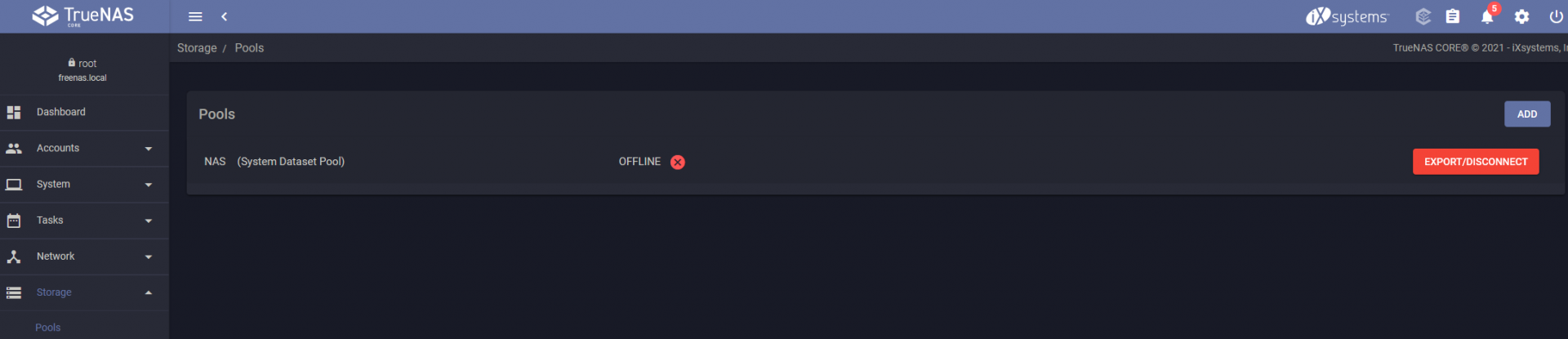

I've been having issues with my system, at this stage I think it was related to a faulty SAS cable but I can't 100% pin it on that at this stage; I have replaced the cable and things seem more solid, drives are no longer dropping off but as the pool no longer loads I can't confirm this. I had replaced a drive since I started experiencing issues, and was about to replace another before I hit the current issue.
Anyhow when I replaced one of the SAS cables (the other is internal in the system) I thought I would give plugging one of the SAS connectors into the motherboard, essentially try to work out if the HBA was to blame.
When the system booted after that my pool didn't even appear in the GUI, I didn't give too much thought to this, I shut the system down and moved the SAS connector back onto the HBA. The problem is now when I try to import the pool I get the error below. I should mention the system did previously use this onboard SAS connection when I only had 3 drives but this HBA has been in "production" for over a year now. Come to think of it moving to the HBA didn't cause any issue so maybe that isn't to fault.

I've added my specs to my signature, in terms of vdevs I had 2 with 3 drives in each. RAIDZ1
