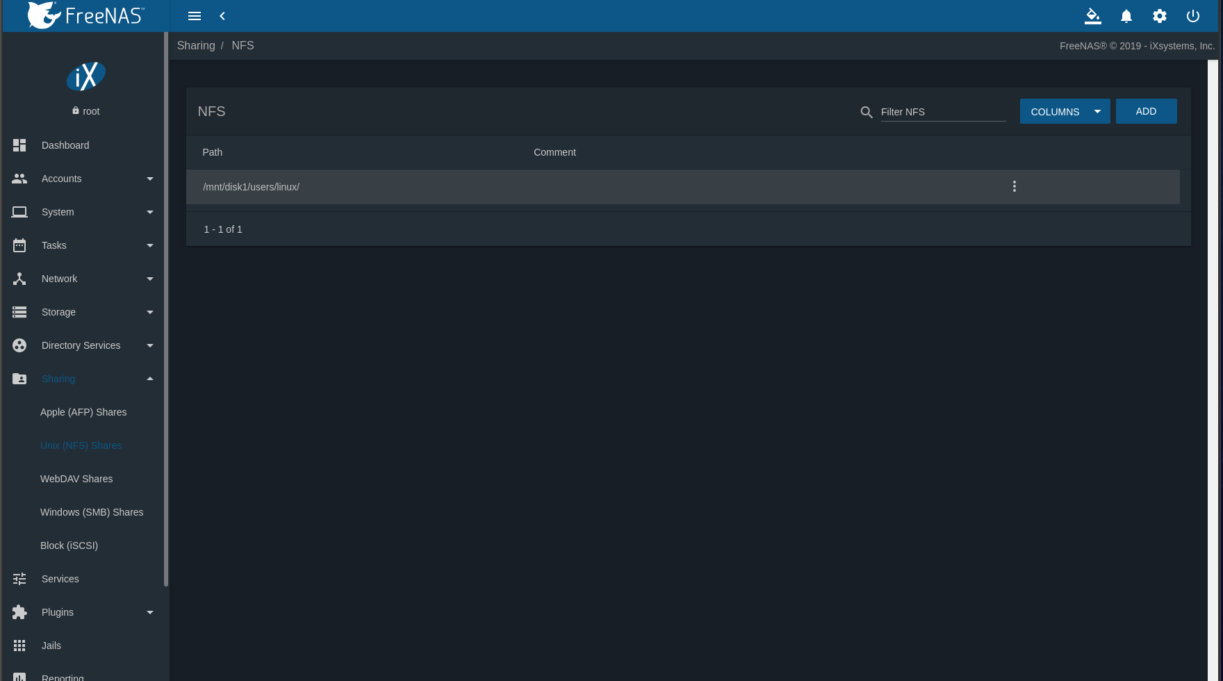

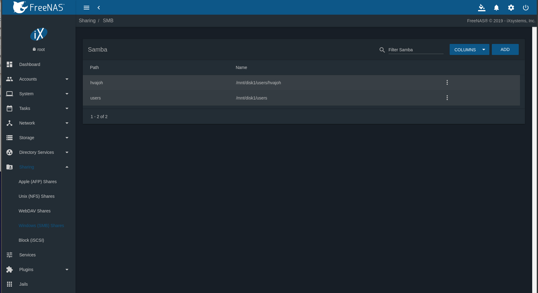

i have done that to samba and unix
Jan 4, 2014
1,644
The users dataset and child datasets are missing in the Pools view. This probably is the cause of the network connection failing.

1,644
