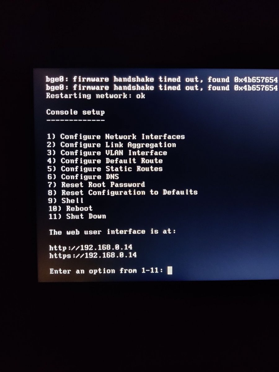

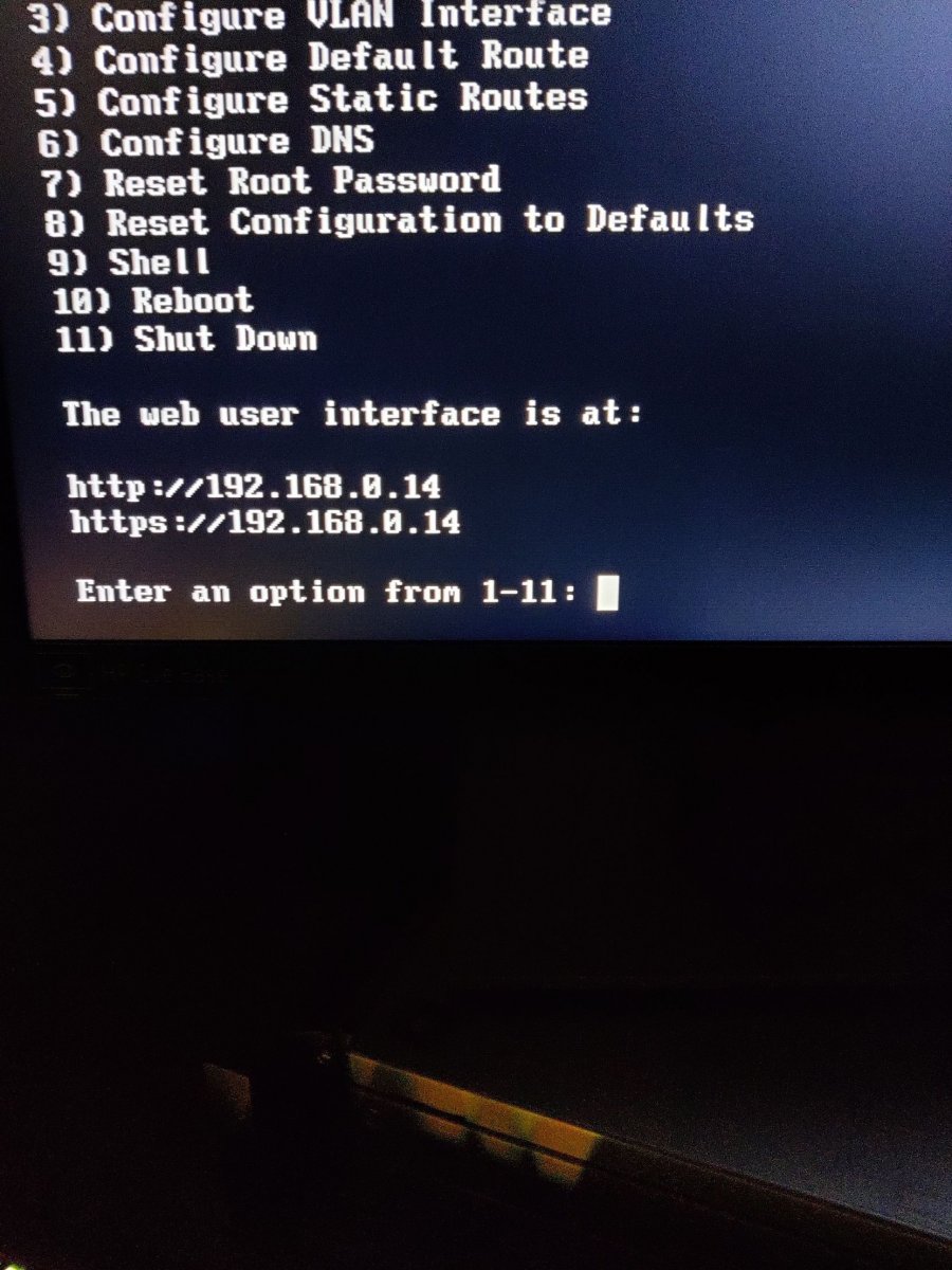

I went spelunking through the Internet for some more information about this firmware handshake error. According to https://dev.haiku-os.org/ticket/13933, this is because a custom HP BIOS has tweaked enough of the onboard Broadcom NIC so it fails to load the TrueNAS (FreeBSD) bge driver. You'll have to use a PCI-E Intel Gigabit NIC, sorry.

Typically these things work OK on Windows, because HP has tweaked the drivers to work with the BIOS. In your case, the bge driver is trying to upload firmware to initialize the PHY, and failing. The OS configuration is correct, but it's not communicating with the NIC hardware.
