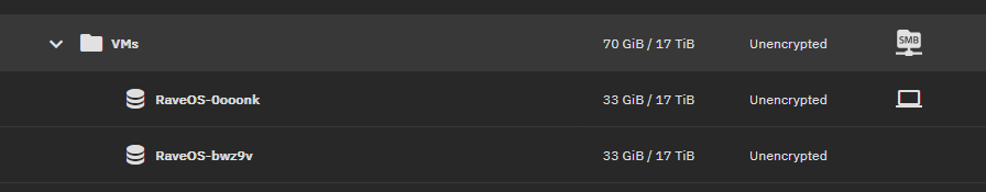

I am trying to add RaveOS(linux) to my Scale server as a VM because bare metal isnt really an option right now.
I originally tried to pass through a usb drive with the image flashed onto it but the vm doesn't seem to like booting from a usb stick. I then tried to flash a zvol with the image but after flashing it the zvol doesn't show up in any of the drop downs. I can't create a vm with an existing zvol and I can't add a disk device for the same reason. I'm not sure what changes after the flash to stop it from showing up.
0ooonk shows up for the vm but bwz9v doesn't. I used iSCSI on bwz9v to use a raw copy tool to make the linux image on the zvol then removed the zvol from iSCSI.
