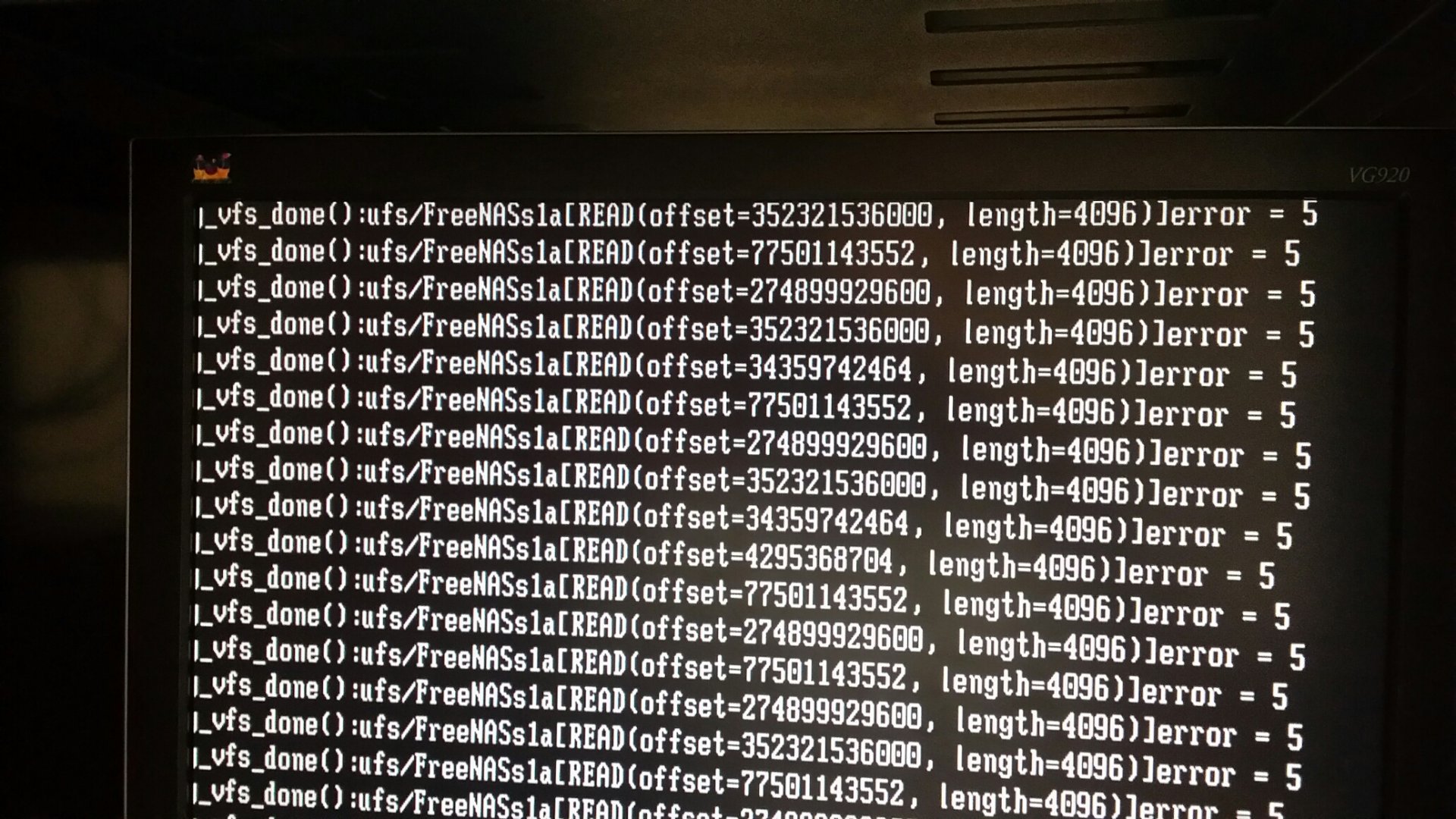

This is showing on the screen. See attached.

A little more detail that I should have added in the original post. I was in the web interface using Chrome and when I was just checking things out I couldn't view the disks or volumes. I thought, well, I hadn't rebooted this thing in over a year so I rebooted. My share wasn't coming back online and I couldn't ping the server so I went to see what was going on and saw a bunch of errors on the screen just like above. I powered the server off and back on again and it seemed to boot ok. I could now log back into the interface but couldn't see my drives. I read somewhere that it could be a chrome thing so I tried Firefox and sure enough I could see the disks and volume. I could access my CIFS share just fine before the reboot. Not sure what is going on. I appreciate the help!
anodos
Sambassador
Mar 6, 2014
9,553
It's possible that your boot media got corrupted. Perhaps FreeNAS was running from memory and when you rebooted it went Kaput. Try booting from a fresh install on a different USB flash drive and importing your pool. By the way, your pool is 97% full. Bad things happen when you get to 100%. You might want to put some thought into how to proceed going forwards.
