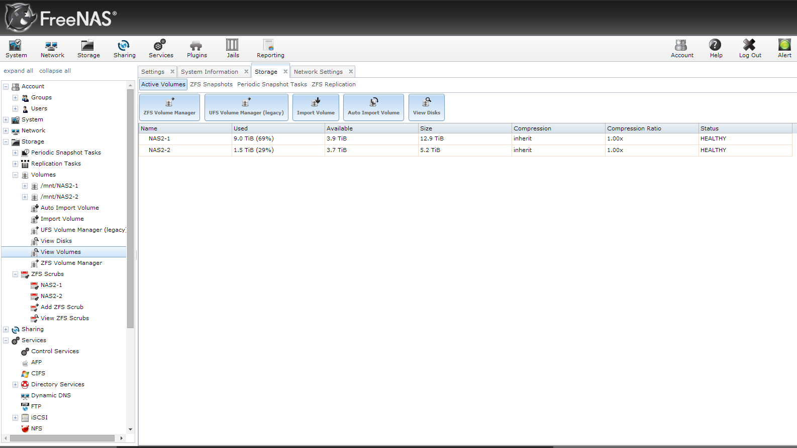

I have trouble with one of my disks and I want to replace it and check it properly. I am trying in the usual way to enter View Volumes -> Active Volumes and then click the ZPool (NAS2-1 ,See the screen-dump ).
I cannot open the pool to see the raid and the disks in the raid.
I do not get the usual eight icons at the bottom making it possible detach the volume, scrub the volume etc etc.
I am running FreeNAS-9.2.1.5-RELEASE-x64 (80c1d35)
I have applied one patch to fix the problem with stopping CIFS but the problem is independent of this. ​
Is there some obvious detail I am overlooking or a change from the previous version? Please advice..​

Did you click on one of the entries. From the manual "If you click the entry for a ZFS volume, eight icons will appear at the bottom of the screen."
If so, try a different web browser.

YES I did click. I am using Chrome on W8.1. I will try IE
I tried IE and then it works normaly .. I feel stupid.. Thanks!!!
